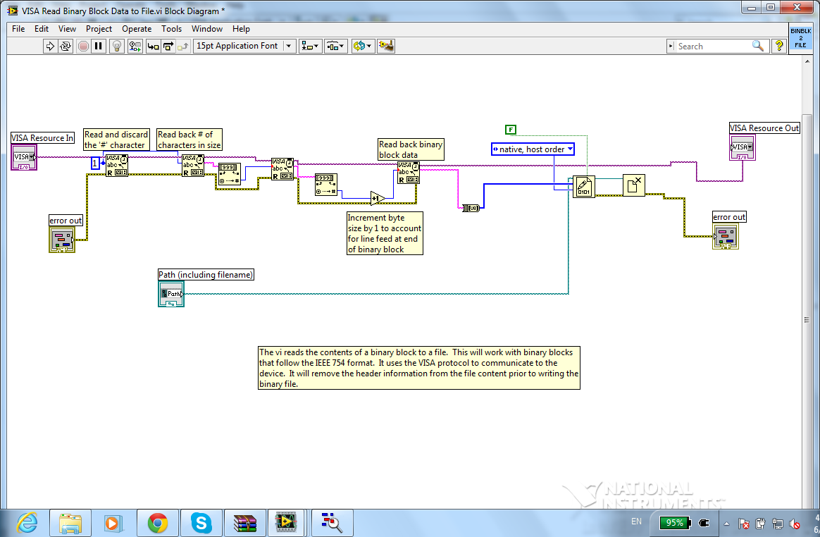

Even though with programming guide, I cannot find out which one is the screenshot command, I searched the net and get one vi as follows
But I always receives errors 1073807339.
I tried the method given here http://digital.ni.com/public.nsf/allkb/2208965FB36F63C3862570E700575074
But unfortunately my E4440A analyzer doesn have Config remote lang » Language » SCPI.
Do u know what is wrong with the VI? Or anything wrong with my analyzer settlements?

Thx man.
I need to save images of the screen just like press the save button on the analyzer, my team (although I am only an intern), especially my boss asks me to do this by this week, I got all the other functions ready except for the saving screenshot one.
I attached the VI at the earlier message, would u help me a bit checking the vi?
I really doubt the problem may be because the firmware is too old.
BTW, I tried to change the timeout but no matter how long the timeout is, same error appear.
I can now save gif file that is 0kb and the gif show 'No preview available'

Try out a VISA read after your VISA Write with smth like "2048" byte count to read. What do you get ?

You get a timeout because there is nothing to read in the buffer. Before reading you need to initiate the file transfer. Often it is done with a print command. I don't remember for the E4440A (it is an old model) but I can answer that tomorrow I'm out of the office today.
