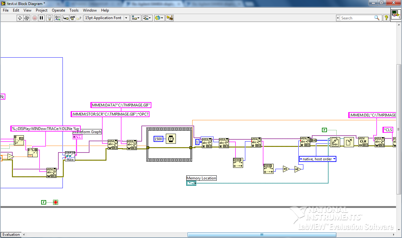

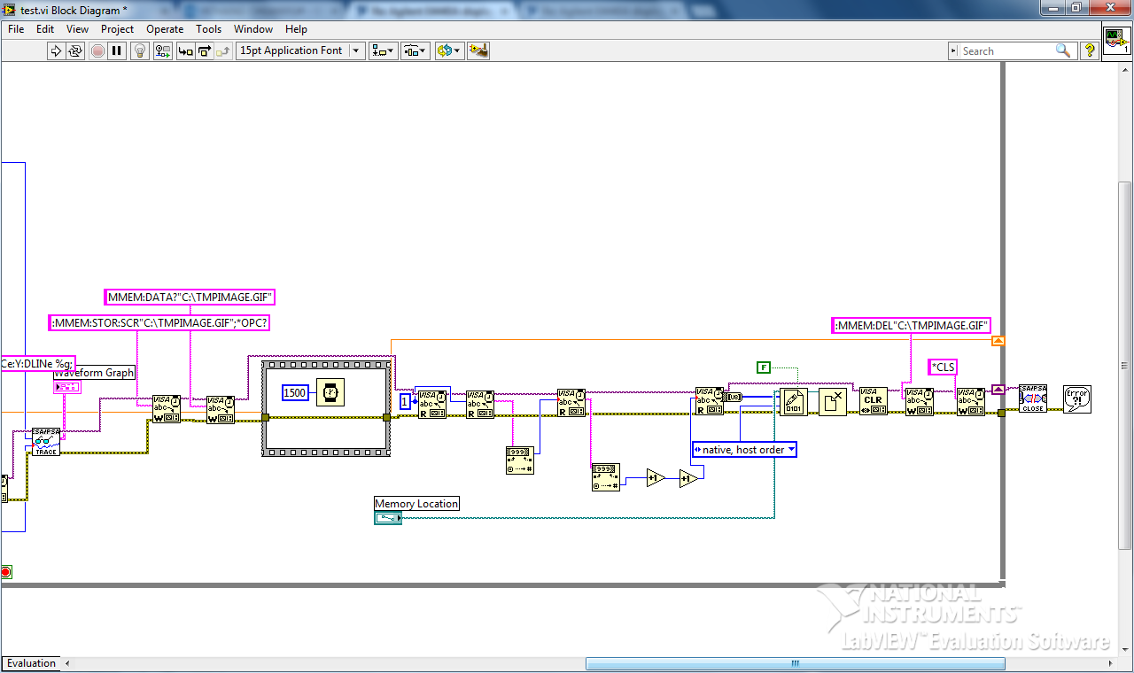

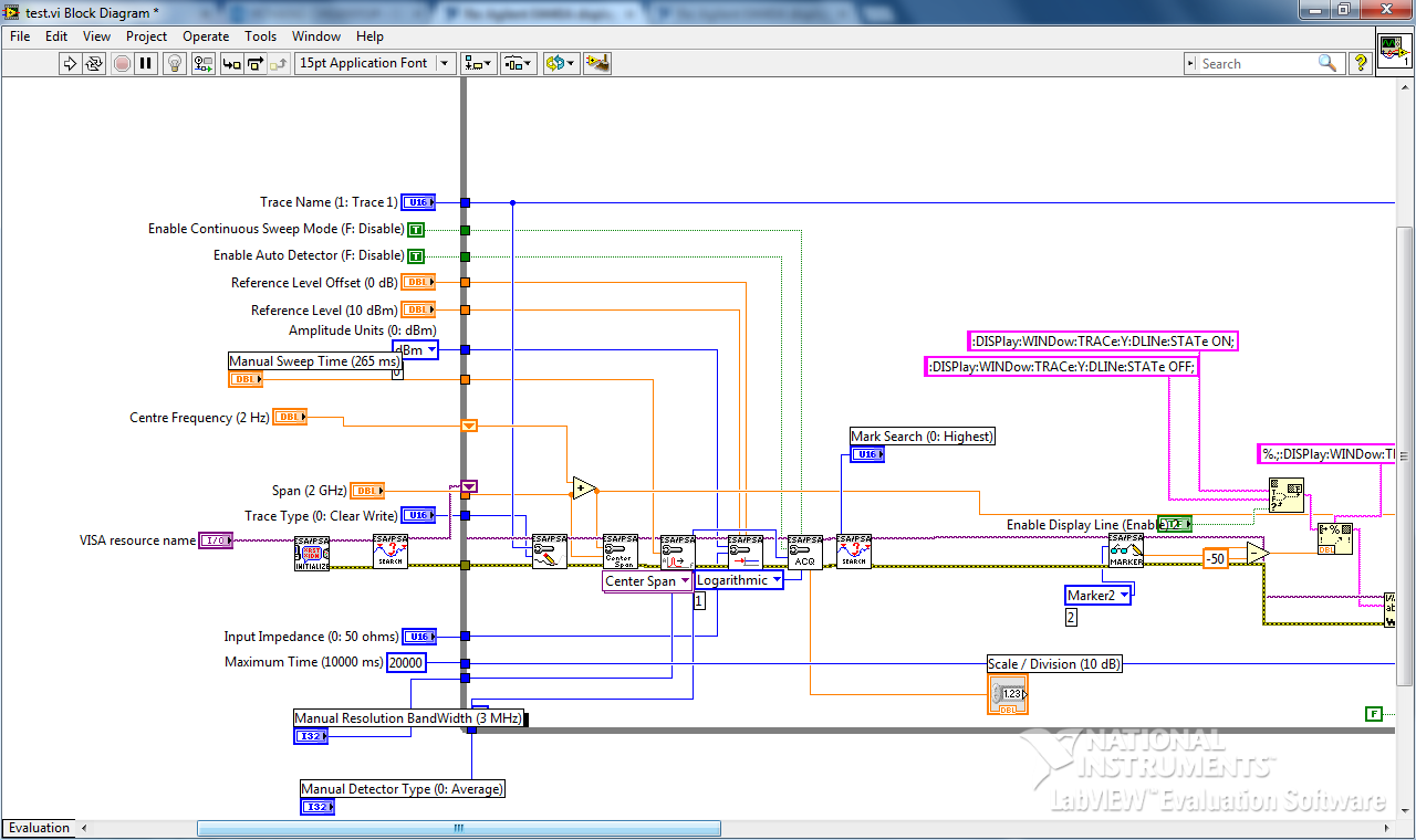

I'm posting by phone. Can you attach an image? No promises since I don't even have the manual for the instrument.
Message 19 of 26
(2,228 Views)
Thx again man, you can just help me check the structure. I am not quite familiar with the structure so it may cause error.1.png2.png3.png
