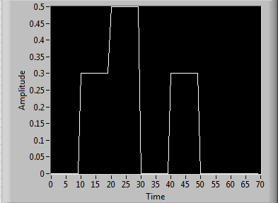

I am working on graphing the output voltage received from a Yokogawa GS200 into a Agilent 34401A. I have adapted the code from the driver for graphing the voltage. The results are very inaccurate, an example attached where the voltage is changing over time and the results are not what would be expected. If possible would I be able not use triggers and use time? I am still new to this and have put in some research but have not found a solution.

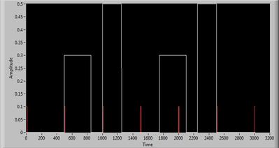

It is likely you are not constantly sampling.  According to your screen cap and code, for seven triggers, you are sampling once every 500ms (for 10 samples of unknown interval).  Assuming 1ms interval, the samples would take place like this: (red spikes are sample times)
The resultant sample chart would look exactly as you posted.
