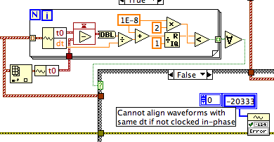

I dug into the Align and Resample VI until I found the error you are getting.  Did you know that you cna open the front panel of Express VIs? Then you can look at the block diagram to see how they do it.  It appears that the error occurs if the differences between the timestamps (t0) of the waveforms does not meet some criteria related to the dt.
