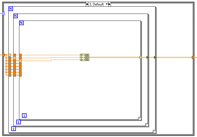

I've achieved this using nested for loops (number of for loops equal to k) (shown below), but this solution is clunky, not easily scalable, slow, etc.
This part of a larger program where each permutation will be evaluated.  Note that order matters; for example, [1 1 2] is different than [2 1 1] and both must be present in the 2D array.

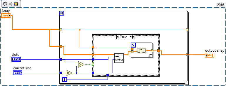

I suspect this will involve some recursion, but I would also think it can be solved without.  And since I don't want to try to figure it out, I'll post some links.
... and yes there may be a few stray wires...

The recursive solution from Mancho00 is much more elegant than the messy iterative one I was working up, and therefore won't bother posting.
Recursion is efficient in terms of the quantity of source code to be maintained.  Your nested For Loop solution is probably pretty efficient for execution time (likely noticeably faster than recursion for large 1D arrays & large #'s of slots).
The main downside I noted in your screenshot was the need to hardcode #'s of nested loops in distinct cases and then feed a hardcoded # of branched copies of the 1D array into those loops where only some of them usually get used.  The recursive solution makes those things unnecessary.
All I did below was to turn Mancho00's snippet into an actual vi so I could set it up with reentrant execution properties and to make it more clear that the visible "outer" code is literally the internal contents of the "inner subvi" being called.
