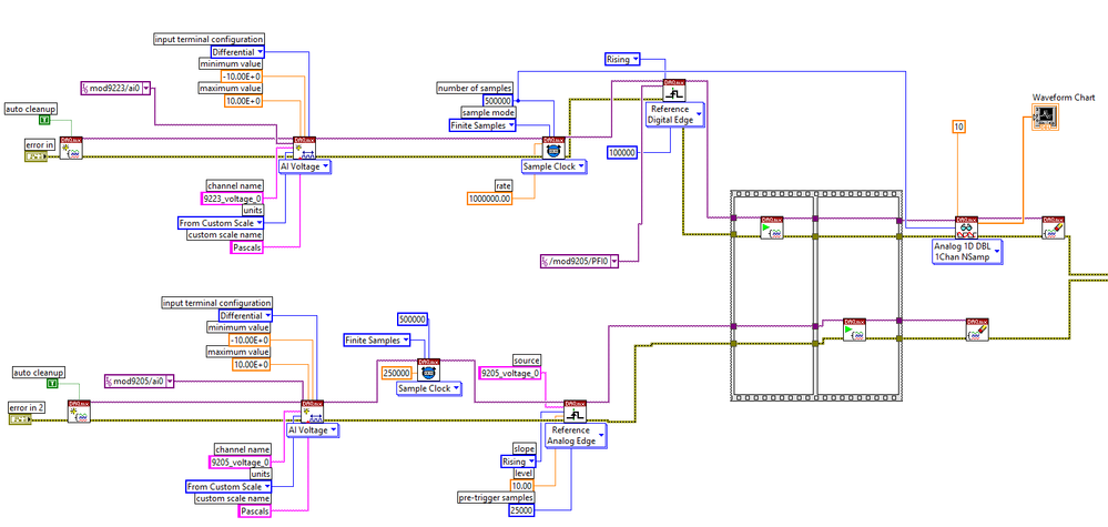

The attached code generates the following error:
DAQmx Start Task.vi:7220004<append>
<B>Property: </B>Ref.DigEdge.Src
<B>Property: </B>Ref.DigEdge.Edge
<B>Source Device: </B>cDAQ9184-1DF93D9
<B>Source Terminal: </B>ai/ReferenceTrigger
<B>Task Name: </B>_unnamedTask<31>
Does this only work with start triggers?
Does it not work with reference triggers??
I tried to change the trigger reference to PFI0 as that Knowledgebase article said and then this happens:
DAQmx Start Task.vi:7220005<append>
<B>Property: </B>Ref.AnlgEdge.Src
<B>Property: </B>Ref.AnlgEdge.Slope
<B>Source Device: </B>cDAQ9184-1DF93D9Mod1
<B>Source Terminal: </B>AnalogComparisonEvent
<B>Required Resources in Use by</B>
<B>Source Terminal: </B>PFI0
<B>Destination Device: </B>cDAQ9184-1DF93D9
<B>Destination Terminal: </B>ai/ReferenceTrigger
<B>Task Name: </B>_unnamedTask<4B>
Message 4 of 28

Well, the code and the linked article both have the non-9205 module configured to trigger off a hardware signal.  That's not going to work if the module doesn't support triggering.  That's what it *means* to not support triggering.
The small ray of hope is that the linked article refers specifically to *analog* triggering.  While the brief datasheet for the 9223 didn't mention triggering at all, I suppose it's conceivable that it might support *digital triggering*.  Your code attempts to use an internal digital signal that your terminal constant refers to as "/cDAQ9184-1DF93D9/ai/ReferenceTrigger".   This differs from the way you specified your device for the channel names -- it appears you might be missing a "Mod1" at the end of the device name?  If so, try "/cDAQ9184-1DF93D9Mod1/ai/ReferenceTrigger".   Not sure that's the problem -- you shouldn't have been able to select an invalid value from the drop-down menu for the terminal in the first place.
Something seems fishy about the fact that your AI channels are designated by identifying devices with a trailing "Mod1" or "Mod4" at the end of the device name while both error messages refer to a device with neither suffix.  Double-check all your names, better yet use built-in DAQmx constants or controls so you can *only* select valid names from the drop-down menu.
-Kevin P
Message 5 of 28
(5,925 Views)

I am home now and using the actual hardware.  I have the code running but it won't trigger.  It just sits there, unless I put a timeout on the "DAQMX Read" function and then it gives me this error (because it's not triggering, of course):
beta_code_2.vi<append>
<B>Property: </B>RelativeTo
<B>Corresponding Value: </B>First Pretrigger Sample
<B>Task Name: </B>_unnamedTask<28>

Ok, gotcha, sounds pretty clear that the 9223 supports digital reference triggering, and can get a digital trigger signal from the 9205 via the cDAQ chassis.  Two more thoughts for you:
1. You're clearing your 9205 task almost immediately after starting it.  When the analog triggering condition arrives, it'll be too late because the 9205 isn't active any more.  And thus it won't generate any signal that the 9223 can receive.
2. The use of PFI0 seems wrong.  Your first code that used .../ai/ReferenceTrigger seemed more sensible.  Another thing to try might be the "Analog Comparison Event".  You may need to right-click your terminal constant, chose "I/O Filtering...", and then enable "Advanced Terminals".  If you find it annoying that NI kinda hides this, give kudos to this idea like I did several years ago.
   You might also be able to do explicit routing using functions like DAQmx Export Signal, but I don't know the cDAQ platform well enough to give more specific advice.
-Kevin P
