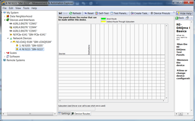

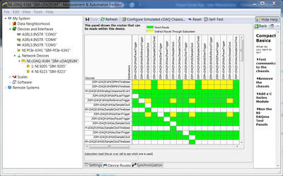

I made a simulated cDAQ system and am not liking what I see in the device routing table. First here's the chassis:
And next here's the 9223 module.  It seems to "own" no timing signals at all.  (The 9205 owns only PFI0 and its AnalogComparisonEvent.)
What I see suggests that the chassis owns the signals and timing engine for AI.  Digging in a little further though, I also see timing signals designated for "te0" and "te1".  A little searching led me to this article.  And now I'm back to feeling better about things again.
The signal named "...ai/ReferenceTrigger" would be owned by one of the ai timing engines, the online help says that the one called "ai" is timing engine 2.  There's a similar signal named "...te0/ReferenceTrigger" that would be owned by timing engine 0.
When you try to configure 2 distinct AI tasks, the article suggests that DAQmx will automatically know to reserve a distinct timing engine for each.  But if you leave it up to DAQmx to do automatically, you don't really know which task (if either) uses ai, te0, or te1.   And if you don't know which timing engine the task uses, you don't know which signal to pick from the drop down list.

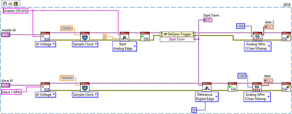

Can you use the Reference.Terminal property node to retrieve the autoconfigured Reference terminal for the "master" task, then wire that to the Source terminal for the "Slave" task? That would solve the issue of needing to specify analog timing engines explicitly.
Also, wouldn't you want the Master device to just use a Start, not a Reference, trigger? I suppose it wouldn't matter either way, but it seems like Start triggers have been a little simpler in my experience. The Slave device would still need a Reference trigger since it needs pretrigger samples.
Sorry I can't offer too much help... I don't have the hardware I'd need to actually run this, and simulated devices aren't great with triggers, so it's all guessing. Kevin's code looks like it'd work to me, but I always hate using explicit names for terminals. It seems to always bite me later on, so I generally try to read terminals from property nodes if at all possible.
Good questions. I am replying on my phone right now and didn't see your reply before my last reply to Kevin.
Perhaps using a start trigger on the 9205 will work if I still use a reference trigger on the 9223 that references what the 9205 does. You've given me more options to try.
You guys are great. Gonna take a look at this later tonight.
Message 24 of 28
(2,019 Views)
FWIW, I like the suggestion from BertMcMahan for sharing the trigger without using a terminal constant.  I'd suggest you try that first, it's a better approach to get in the habit of using.  I almost always do it that way too, I was just kinda locked in on the idea of making minimal changes to your code.

Give this a shot. I'm not getting *quite* what I expect from the simulated hardware I have in MAX but it might work with the real thing.
I realize the Slave task should be started before the Master task, but the Start Terminal property node isn't valid until the task starts. It's probably fine here though as the time offset will be super small.
Message 27 of 28
(1,975 Views)
I was just fiddling with simulated devices here too and had pretty much the same thing in mind.  Only 2 additional comments:
1.  You can make a call to DAQmx Control Task to "commit" the 9205 task without starting it.  You can then validly query the trigger terminal and still start the 9223 slave task before the 9205 master task.  (As mentioned in "explain error" when I got one initially by trying to query the 9205 task too early.)
2.  You should generally get the same 9223 behavior whether the 9205 is configured for Start Triggering (as shown) or Reference Triggering (as you started out with).  It'll probably be easier for you to confirm your timing and sync if you switch back to Reference Triggering though.
   There's the tiniest of chances that it could be important to do Reference Triggering based on the following unlikely (but possible) scenario.  I don't believe that a reference triggered task will respond to a trigger signal until after it has acquired the specified # of pretrigger samples.  When both devices use reference triggering with the same amount of time worth of pretrigger samples, you can't miss signal at the 9205's trigger terminal.   If the 9205 uses Start Triggering, it's *conceivable* that the trigger signal could assert before the 9223 has buffered the specified # of pretrigger samples, causing the 9223 to ignore it.
-Kevin P
