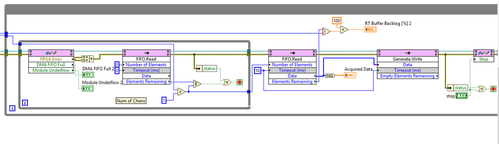

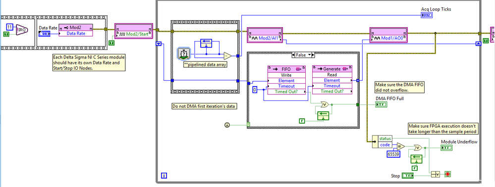

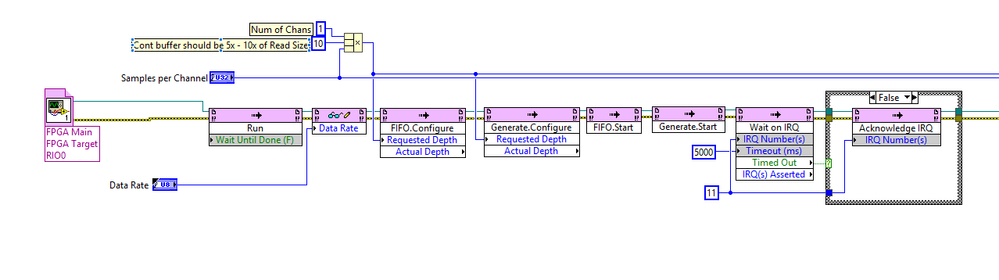

I am a student and new to LabVIEW.  I want to build PID controller for my project but before that I need to synchronize two modules which I am using with cRIO-9035. Basically I want to acquire signal with NI 9232(Input Module,24bit) and send it back to NI 9269(Output Module,16 bit).

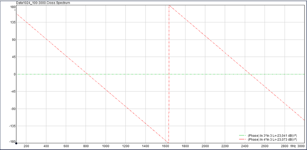

I have successfully completed this task of acquisition and generation. However I am getting phase shift in the output signal. For further stages of my project , I want signals to be completely or nearly in phase, not much phase shifted.
I have been working on this task for quite long time but not getting where the error is.

FPGA ViFPGA ViRT MainRT MainRT Main_ContinuedRT Main_ContinuedPhase diagram for sweeping singal(100Hz-3kz),(Green -Input, Red -Output)Phase diagram for sweeping singal(100Hz-3kz),(Green -Input, Red -Output)
