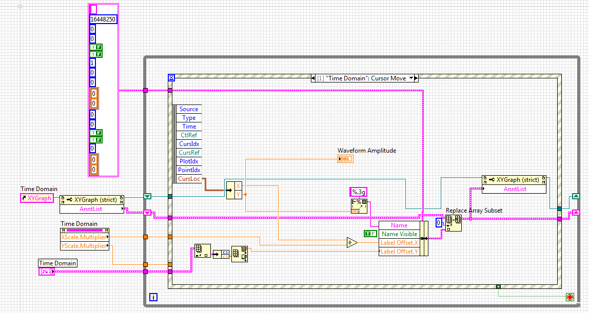

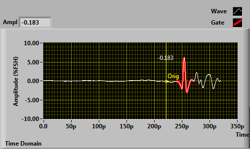

Folks - No matter what I try (whether [index - snap] or [position - free strategy]), I am having some problems with having the annotation move to the cursor X,Y position on the plot as the cursor is moved across the plot.  This is an XY graph with multiple plots.  The zero plot is the waveform and is what the annotation should be following.   Need a second set of eyes to look at this one.
ps. this is in LabVIEW 8.5.

Hi Don,
For what it is worth to you, your code works as-is in LV2009.  Prior to that annotations in XY graphs with scale multipliers was messed up.  All is not lost, I can't test on this machine, but try the following.
In your Bundle By Name, in Label.Offset.X wire in X/XScale.Multiplier where X comes from CursLoc.  Similarly for Label.Offset.Y wire in Y/YScale.Multiplier
This will (I think) cause the annotation to track the cursor position, you may need to tweak if you want the label on one side or the other.
(5,355 Views)
Hello Darin -
I think your strategy works if I remove the PostionX, PositionY, Index inputs that might either conflict or have no impact if I'm not going to show the arrow. What I decided to do was use your suggested strategy for Xposition of the label and then just use the raw data Y max as the constant Y Position.  THANKS!
