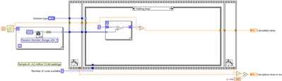

I've attached a VI I created (back-saved to 2018, but I am in 2021 if that matters) to do time trials with 7 different methods, with the case that is consistently the fastest just being a simple FOR loop, as shown here in this case:
On my dev PC this completes in around 7 ms.  (The PC that will run this software live is much newer/faster, but I'm just trying to improve it relative to execution times on the same PC).

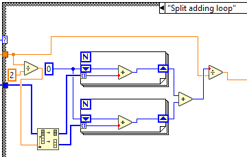

One of the alternatives I tried was splitting the array so it would perhaps run on 2 cores to bring in some parallelization:
This, along with another option that uses Decimation, usually end up taking a lot longer (18-20 ms).
But the main reason I am posting here is that on a few occasions that I have been unable to repeat consistently, the "split" cases where I divide the array would instead run in 4 ms or so, nearly a 50% reduction on the best time I can achieve.  This would happen a few times in a row, usually after not changing anything or after changing something in one of the other cases, but as soon as I would try to copy the code or neaten it up before copying it it would instead go back to being (relatively) slow at the previous 18-20 ms.

Don't forget that you can parallelize your "adding loop".
Even though there is a shift register, the compiler recognized the pattern and parallelizes it just fine. Faster that any of your alternatives on my laptop. (similar for U32, I32, or DBL)
This is efficient because there is no new allocation of the entire input array in another datatype like in some of your other attempts..

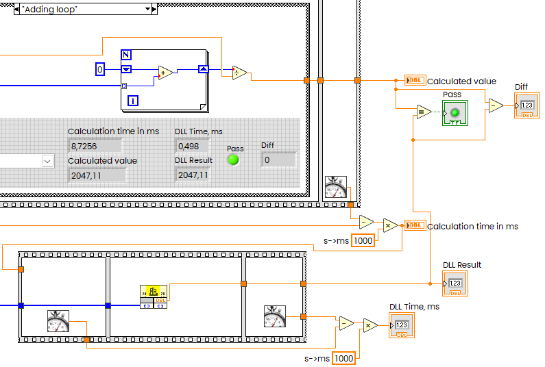

Less than millisecond on my ancient i7-4940MX and faster than any other:
Downgraded to LV2020 + Visuall Studio 2022, code in the attachment, 64-bit only.

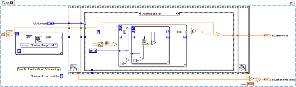

Inspired by Andrey_Dmitriev, below is slightly faster on my computer, ~.2-.3ms, than the parallel add. Break into parallel chunks, add in U32, then convert to double.
Message 5 of 23
(2,907 Views)

@Kyle97330 wrote:.
Andrey_Dmitriev, that is an impressive block of code to drop, but I think Altenbach's solution is what I'll go with to avoid unnecessarily bringing Visual Studio and DLLs into this.
Thank you!
From what I see, the single-threaded DLL is still faster than the parallel loop (which, of course, depends on the number of cores used). However, I can also put it into a parallel loop, and in that case, the LabVIEW code stands no chance of competing.
This is a common issue — not just limited to LabVIEW: the poor performance of modern software is often masked by multithreading on modern multi-core CPUs. Typically, I focus on optimizing the single-threaded version first. Once it's performing well, I consider running it in parallel — if really necessary and feasible.
When intensive computations are performed using native LabVIEW code on native LabVIEW arrays, the efficiency is quite low (depends on algorithm). It might only utilize 10–20% of the CPU’s potential — not in terms of CPU load, which may be close to 100%, but in terms of actual CPU's instruction throughput per loop iteration.
On the other hand, premature, unnecessary, or overly aggressive optimization is the root of all evil.

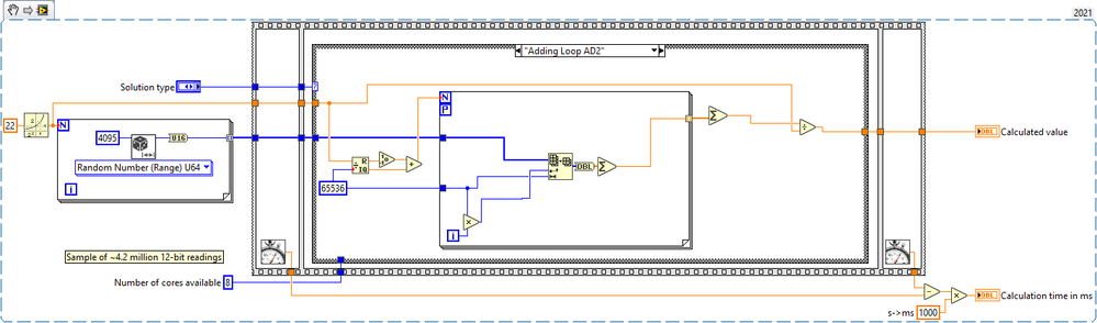

This one reduced the adding loop a bit more. One my computer the parallel adding loop had an average ~1.4ms, this one is typically just under 1ms, ~.9ms. No shift registers needed.
Message 10 of 23
