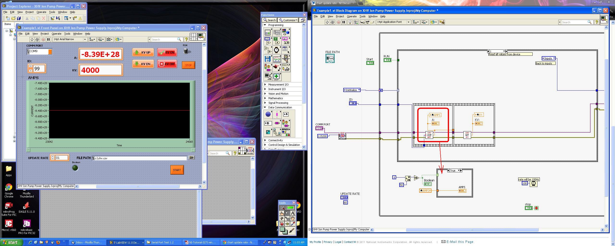

I am develiping a driver for a new instrument.  I have the basics working, based on the vi tree tutorial.  Now I am trying to create a basic example.  I started by watchin a state machine tutorial (a soda vending machine).  I have 3 states, basically init/read data/check buttons&write. Everything works great, reading and showing data. Now want to add a chart for one of the data (amps in this case).  Trying to implement the method of using the loop's counter.  Loop cycles at 100ms, for now trying to update at 5 secs (eventually needs to be user input).
So basically I have a simple state machine that updates values on the screen in a certain state.  I need those data available to the top level for charting or possibly turning most of this (minus chart) into a stand-alone vi.
So anyways I have a boolean LED in the main loop that blinks every 5 seconds. So far so good.  Except that the chart updates seemingly randomly??  Put the prog in watch mode, and saw the chart update when the data was read (inside the red box). Didn't do it every time.  I'm just setting a local variable inside the red box...  I see sporadic updates on the charts, maybe 5-10 updates every 5 secs.  What am I missing?  If I change the loop iterations to a faster number (say 10ms) the chart updates likes crazy (even though the CASE is false)!

The chart will update any time a local variable referenced to the chart is updated.  So the chart should be updating whenever the code in the red box executes.
The code that you have in the case structure isn't actually doing anything.  It is simply reading whatever data the chart contains and writing back to itself.
Something you could try doing instead is wiring the output of the Get Amps VI directly to the AMPS chart inside of the 5 second delay case structure.  This will update the chart with only the most recent data point every 5 seconds.  Is that what you want?
