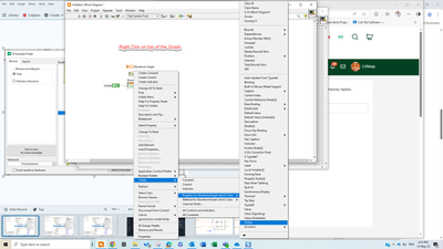

You can right click on top of the graph indicator and create a Property Node - VIsible. THen you can wire teh boolean swith to change the property to visible or not. Do the same for both graphs and you will have what you need.
(1,139 Views)

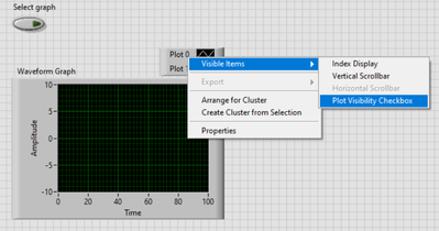

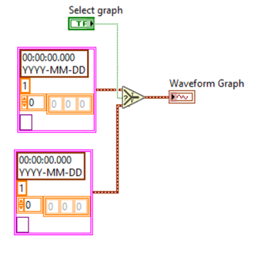

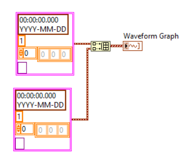

One example among many:
The simplest solution is to send both to the same graph and show Visibility checkbox
