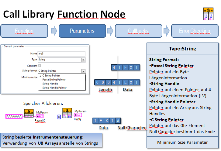

When configuring a Pascal string pointer, you must wire a value to the string input on the block diagram. That value must be initialized with enough characters to hold any new string that may be written to that Pascal string. When configuring a C string pointer, you have two options:
Wire a value to the string input that is initialized with enough characters to hold any new string that may be written to that string.
Specify the string size in the Minimum size pull-down menu on the Parameters tab of the Call Library Function dialog box.

Thank you, I'll try to go with the handle method, pointer to a Delphi string reference. Still funny that LV string and Delphi string are the exact same beasts, yet can't interoperate seamlessly.
