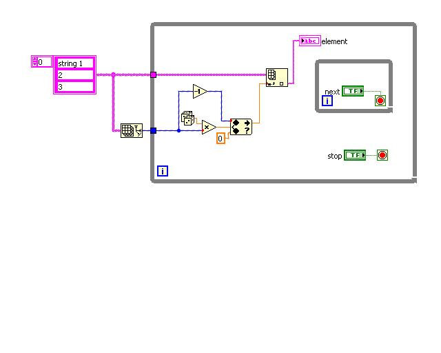

Anyone please help, how can i display a random display of string in a tab then if i click on a next button, the program shall replace the previously displayed string by another random string on the same tab? is this possible? what should i use to do this?

rndom.JPGNeeds polish but you get the idea.

I'm not very sure what exactly you are trying to do but i think you can refer the attached vi, you'll get some help from where you'll be able to go ahead on your own..
