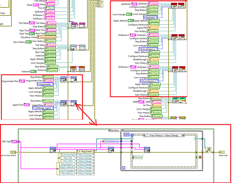

This is an image of what I suggested above.
 At the top of that image you see the Main VI that holds all of the controls and indicators and two red boxes highlighting two examples of passing control refs to re-entrant sub-VIs.
The double headed arrow show the block diagram of one of the re-entrant sub-VIs and illustrates how simple the sub-VI can look if you use sub-VIs to handle a handful of controls and references. In the case above the equipment being monitored is unique and completely un-coupled from any other functionality aside from sharing the GUI and some common buttons used to stop/stop/save.
Using the approach shown above, all operations related to one of the widgets being controlled are handled by the sub-VI and the Main VI does not know about or care what button was punched since the sub-VI handles all of that work.
But you do not have to go all of that way and just take a first step in that direction by creating the sub-VI that updates the GUI via control references and make sure you are passing the proper queue ref to the sub-VI.
Not trying to convince, only offering alternatives to help inspire,
Ben
