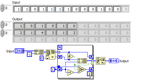

There are many simple ways to do this, here's one possibility:
(once you tell us your LabVIEW version, I'll attach the code)

Accepted by topic author sebas98
@sebas98 wrote:
The input array would be of type double, as well as the output array. The output array should be in just two rows.
OK, did not see your response. You can definitely make my code into a subVI.
(Note that you might need to tweak a few things if other numbers can occur in the input. In principle it will work with any number of different values, not just 0,1)
