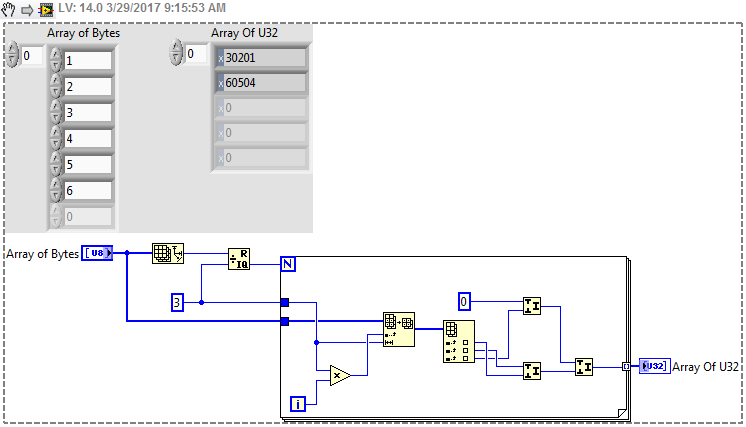

Accepted by topic author DPJones
Loopless: check.png
(Set byte order by changing the wiring…)

Another option using Reshape Array before the FOR loop.
Message 6 of 15
(6,692 Views)

Hi
There are only 3 bytes used it is a 20 bit number the top byte is not used and the LSB bits 0,1,2,3 are not used I shift right 4 once converted to a U32.
Message 8 of 15
(6,671 Views)
