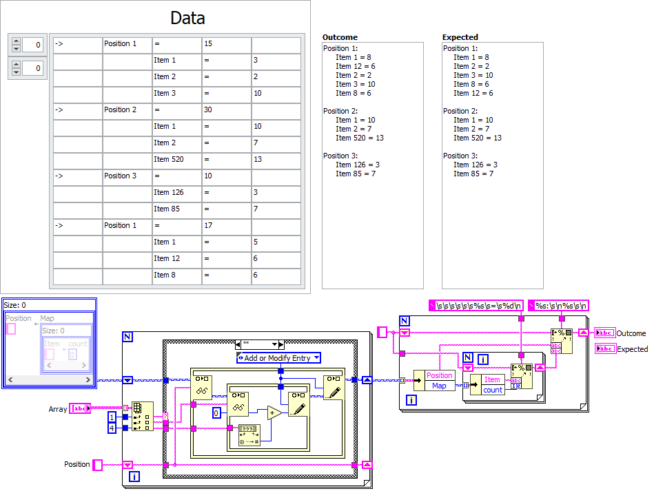

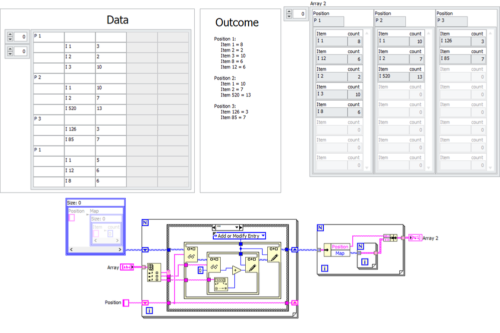

Sorry, I did not wait for your VI but made a simplified version, see attached. You should be able to easily adapt it to your data.
Here's what I meant using a map of maps. Formatting the output in any other way would be trivial to implement inside the last loop.

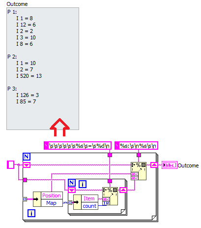

Here's how the last loop stack could look like to format the output as shown:
Note that the code does not need to know the possible items and blindly counts whatever names occur in the various fields, then increment the counts.

OK, it took me one minute to plug in your actual data. All that was needed was changing the indices of the relevant columns:
The only difference is that items are sorted alphabetically instead of numerically (e.g. item 12 before item 2), but that would be easy to fix if needed. I assume that you have real item names instead, so this is irrelevant)
