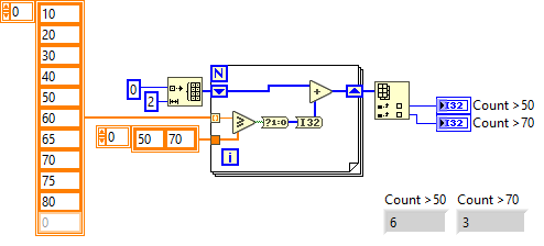

Well, you need two counters, so an array with two elements is useful. Here's a simple draft:

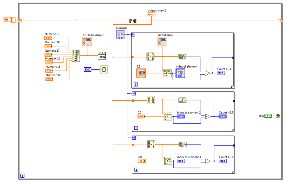

I appreciate all of the help. I ended up going with the array sorting feature and do a 1D lookup each time while comparing the index to the array size. All of the help greatly increases my understanding in the program and it is very helpful. Thank you all once again. I have attached a copy of my code just so you can reference and see how I went about doing it.
Quick background: The Numerics at the start of the code are incoming data points from a tester. Take the mean of those points and place them into an array and count how many times each point occurs (part that you guys helped me on). Hopefully this makes it understanding of what I am trying to do.
First of all, sorting is O(NlogN) and each array element needs to be touched multiple times. In my code, each array element is only touched once for greatly improved performance, especially if the arrays get large.
Now let's look at your image (code) you attached above:
Tracking%20ScreenshotTracking%20Screenshot
There are many things horribly wrong with this! All you need to do is keep a second shift register in the outer loop containing a I32 for each comparison, which each would get incremented according the the output or "mean" (similar to my code).
Specific problems:
  • each time you add an element to the array you start over sorting from scratch. The first acquired element will get processed N times. Once is enough! You sort ever-growing arrays from scratch, even though only one element has been added.
  • Your FOR loops make no sense. They operate on the same input and produce the same output X times according to some control as fast as the computer allows. What a waste! Once is enough! Remove the FOR loops!
  • Your controls and indicators don't belong inside the FOR loops. If the controls would change during the execution of the inner loops, you would get completely random results and since they are fixed, they should be diagram constants anyway.
Message 7 of 8

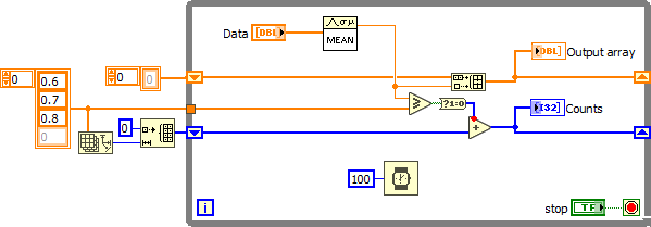

Here's what I would do... (Just a code skeleton, so modify as needed, e.g. depending on where the data comes from, etc.)
(Now each mean is touched exactly once and never again!)
(And there is nothing wrong with this coercion dot ...)
