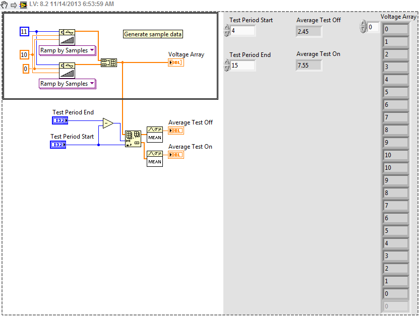

Use Delete From Array.
Jim

  1. My image is a VI Snippet.
  2. You'd have to use Array Subset three times to do what one Delete From Array does.
  3. VI attached
Jim
