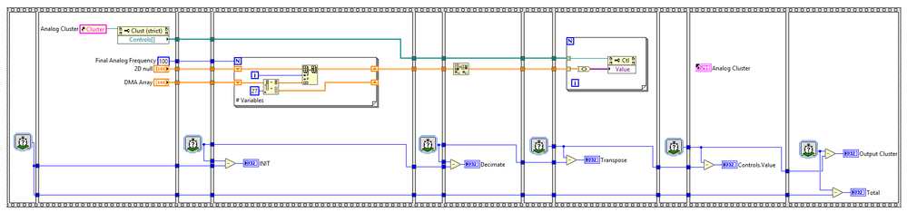

I have an array of interleaved data coming from a DMA fifo in a compact rio. This data has 27 variables, and 100 values for each variable.
I want to put this data in a type def cluster of arrays, 27 arrays (1 array for each variable) of length=100 each one. I have developed the following code (based on this) but is too slow:image.png
It takes almost 4 seconds to execute, and I need to execute this code every second. Here you have the detailed timming in nanoseconds:image.png
As you can see, is the loop that is setting the cluster values which is taking too much time to execute. I don't know why is taking that long. The most strange part is that the cpu is far away from 100% during execution. It is between 10/20% (NI MAX values), so I don't know what is happening here.
Someone knows what is failling here? Or how to do it faster?

because you use reference to the object and you update it every iteration of the for loop.
Change your strategy. convert to data and then update once your indicator.

Your code is doing several things that are slow, but the killer seems to be where you update all this data by reference. It's taking 3.5 seconds all on its own.
Also, it looks like the other loop is turning a 1D array into a 2D array. The way you are doing it is also very wasteful as there is a built-in function (Reshape Array) that does that very thing.

Ok, so reading what you have answered me, it seems that the big part of the waste is in updating the data by reference in a loop. I didn't know that write values by reference was slow... I'm doing it by first time.
Then, as Benoit said, I should first build the cluster with the "analog data", and then write this cluster once in the typdef cluster by reference? Like this?
image.pngBut the problems is how to build this cluster from the 2D array in an easy way?

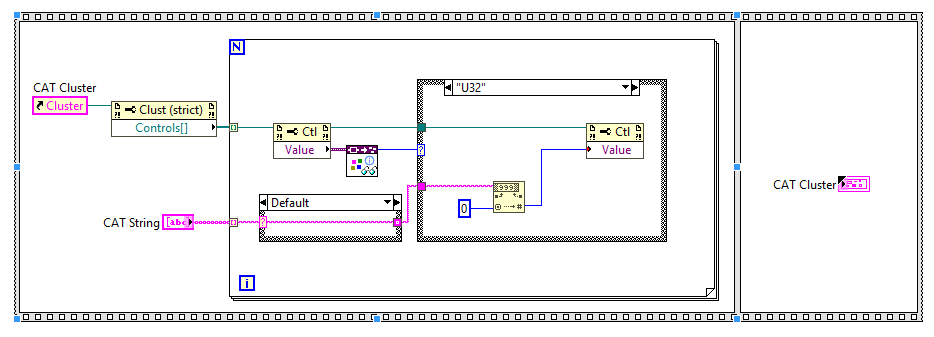

I have another case were I'm having the same problem, but the input is not a floating point array from a DMA, but a string where inside there is different data type: Numeric, floating point, boolean, string variables... So I can't create an array and then index and bundle it. I should do an array for each data type... Wich is not praticall at all. Now I'm doing it like this, but takes 15 seconds to execute (for a cluster of 57 elements):image.png
How can be this done programatically? It was my first time working with references, but they do not seem to be an option due to the high time cost.

Why would you have a cluster of 270 elements? Why do you have a cluster of 57 elements?
As I mentioned before, using the control value property node is extremely slow. How is the string array mapped?

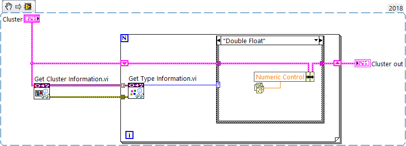

Do you need to use references?
Can you use something like this instead?
Cannot test it, since you did not include any vi or cluster.
