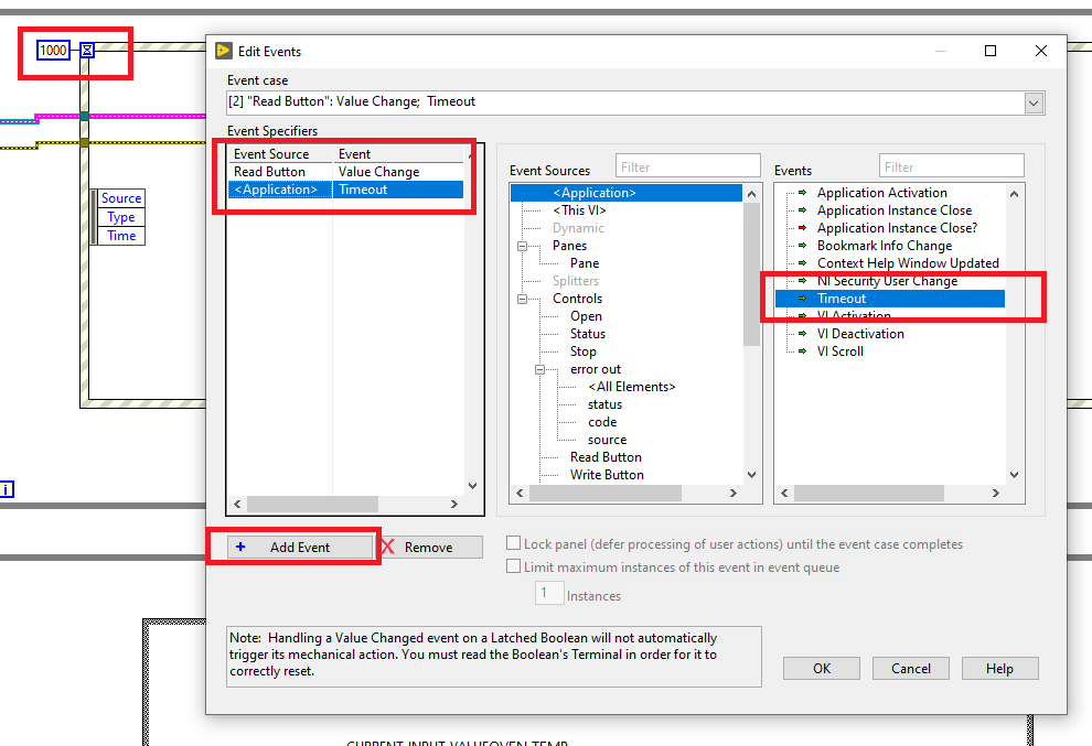

If you mean the Read button, then yes.
Inside the Event Structure that handles the button press, all it's doing is sending a User Event.
Create a timeout case in the same Event Structure, then send the same user event. Set the timeout to 1000ms and you're done 🙂
Edit: in fact, just go to the Read case, then right click on the border and choose "Edit Events handled by this case" then on the left, click "Add Event". Select "Application" from the middle column then Timeout from the right column. Complete by wiring a 1000 to the hourglass at the top-left of the event structure.
Adding a timeout caseAdding a timeout case
This approach assumes that no other events occur during the 1 second. I think that in this case it will generally work - but if, for instance, the user were pressing Clear Error once every second then the timeout will never occur. For this reason I don't like using the timeout for timing. I would just send the Read command every 1 second in its own loop - it's just sent via a queue.
