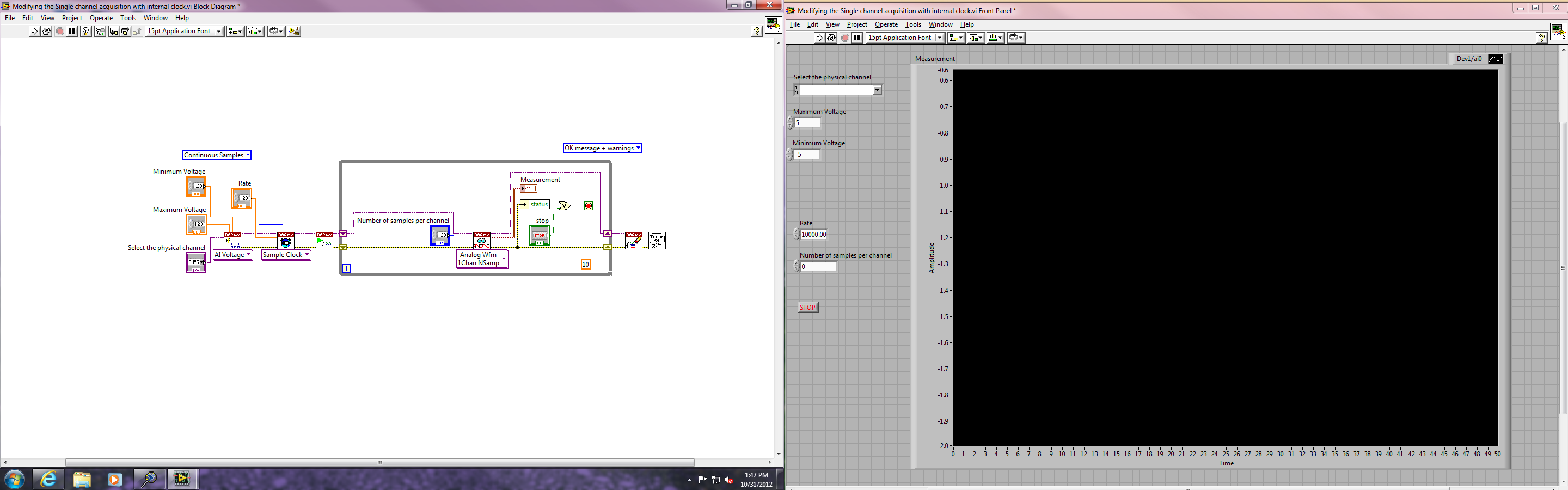

Thanks for your reply. Here is the screenshot of my VI. I need to attach the property node inside the case structure right?
Thanks in advance.
(3,593 Views)
(Screenshots are nearly useless and you don't have a case structure yet. It is always better to attach an actual VI.)
Yes, place a case structure inside the WHILE loop, place the property node inside the true case, and trigger it with a latch action button as needed.
