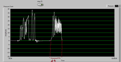

Can i make a time interval, where i can measure average value for a waveform chart ?
for example fom 0:30 to 0:45

With a graph it is very easy - use cursors.  However, charts do not have cursors.  You can use a property node to get the chart history data and use array subset to extract a portion of that.  This will not give you a visual indication on the chart of the data you want to average.
What happens if you are selecting some data to average and it "slides" off the chart while you are selecting or after the selection but before the average?

When you are displaying data on a chart, the newest data is appears at the right of the previous data. When the chart history buffer is full (default length = 1024), adding a new point deletes the oldest point.  Visually it appears that the data slides to the left as new data is added to the right end.
My question relates to how the user would "tell" the program what data to average. In the image you posted you marked a segment of the data to be averaged.  Suppose the user marks point "A" as the beginning of the segment. While the user is deciding where to put mark "B" additional data is acquired and point "A" disappears because it is beyond the history length.  What does the program do in such a case?   A slight variation is the situation where both "A" and "B" have been marked but some of the data is deleted from the history before the averaging or other processing has begun.

If my measurement test is about 1 hour, then i can set X.Min to 0 and X.Max to 60*60. I think i can ret rid of "sliding" when i use that method ?, so the chart automatically stops after one hour.

I don't really need a running average, but a average between a Min.Time and Max.Time i will adjust from the Time-axis.

If you are doing post processing then, just put every data in an array.
Find its subset by taking indexes corresponding to Min. Time and Max. Time and caculate average.

I really want to determine the average value from the peaks in the chart (i'm measuring pressure), so it will be a long way, if i'm going to find the Min.Time and Max.Time from the numbers in the array.
