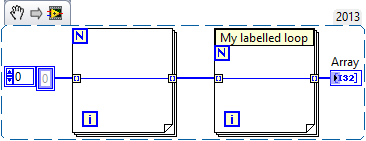

Before conversion:

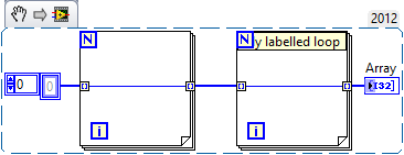

After conversion:

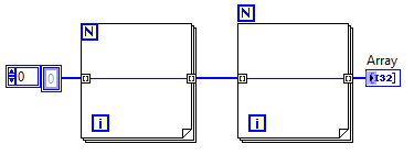

If I then select the 2nd loop and hide its subdiagram label, the 'N' terminal moves up, ABOVE the loop (No snippet, because the 'N' simply disappears from the snippet).
There's no way to fix it, except to remove the loop and make a new one.

Sorry for not being clear before. My original snippets show:
  1. Original code in LV2013.
  2. What the code looks like after I converted it to LV2012 and opened it (without any other modifications).
This is what the code looks like AFTER I hide the subdiagram label in the converted code:
This happens regardless of whether I open the converted VI in LV2012 SP1 or LV2013.
