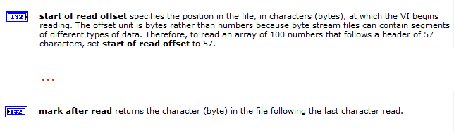

today I came over the VI "Read delimited Spreadsheet" to make my programming life easy. There I stumbled over the output "mark after read (chars)", whose meaning I did not immediately understood, since I'm not a native english speaker. In the LabVIEW- Help there is written:
mark after read returns the character (byte) in the file following the last character read.
For me this sounds like, here is returned the character itself, which is following the last read character. But this leads me to two questions:
  1. Why is it of type I32, and not U8, which would be expected with the annotation "returns the character (byte)..."
  2. This information seems for some tokening- operations useful, but this task is so rare, that it seems strange in this High- Level- VI.
OK, in short, after diving into the hierarchy of this Polymorphic VI (I used the DBL- instance), it turned out to be the file mark position after succeeded read operation, which is only almost the same as described. At least for me...
And on the way down I found a far better explanation for this terminal in the description of "Read File+ (string)":
mark after read is the location of the file mark after the read; it points to the character in the file following the last character read.
IMHO this explanation is far less misleading and should be used for the terminal.

Of course it does not make sense to output the last byte, because you already know that. Basically it is used to in symmetry with the start position (where the help is better!) if you need to read the file in chunks instead of all at once. If you feed it in a shift register, you know where to start reading next time.
A more serious problem IMHO is the fact that files can of course be larger than the range of I32 and file positions are actually I64. (If you dig inside, you'll eventually see a coercion dot where it is wired to a terminal that expects I64).
