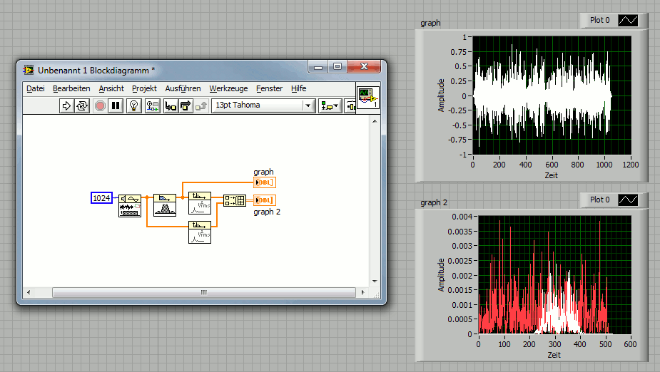

Using that bandpass function clearly shows a bandpass behaviour on some white noise:
Message 2 of 8

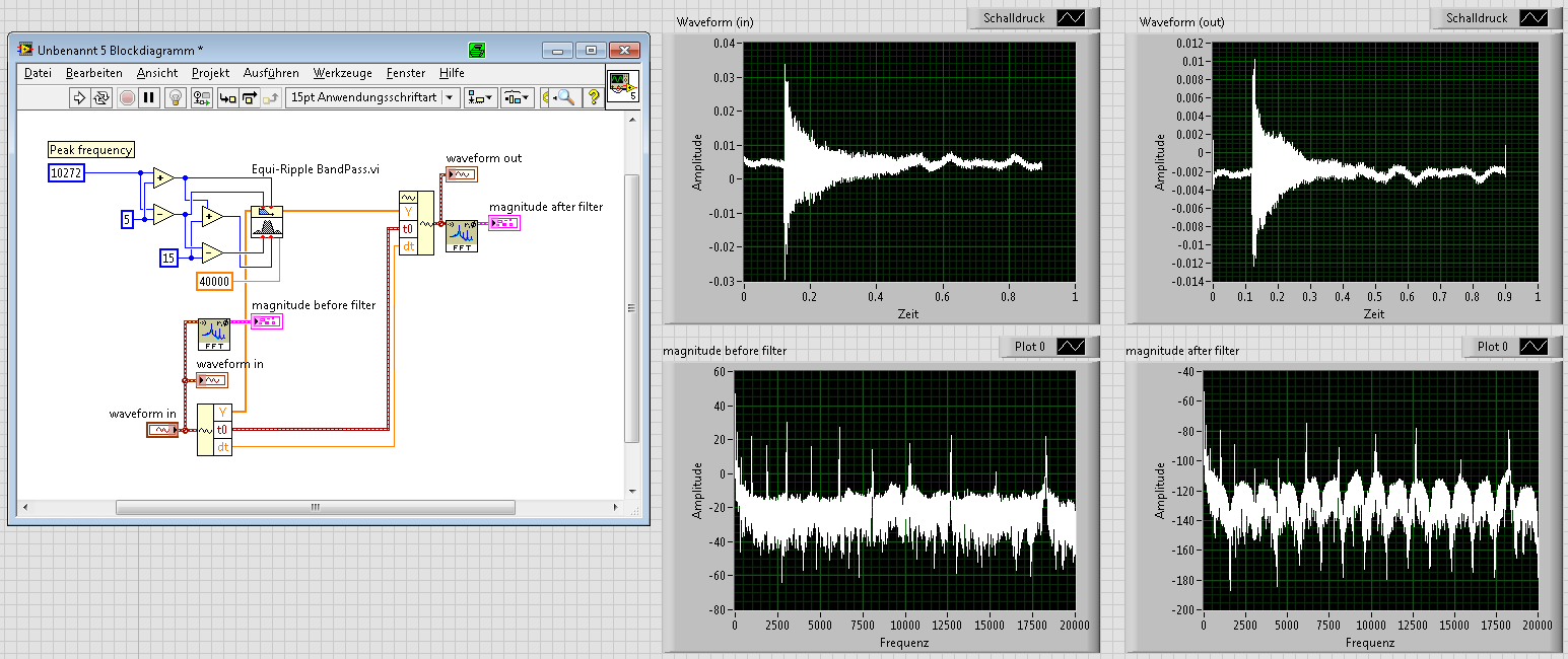

I created a simplified demo VI:
I'd expect the FFT after the filter (bottom right graph) to only show the peak at 10272 Hz, as I limit the passband to ±5 Hz around the peak.

Hi freijon,
well, your filtered waveform shows frequency amplitudes around -120db, where the original waveform has -20db. So the bandpass filtered quite a lot…

It shouldn't filter around 10 kHz though...

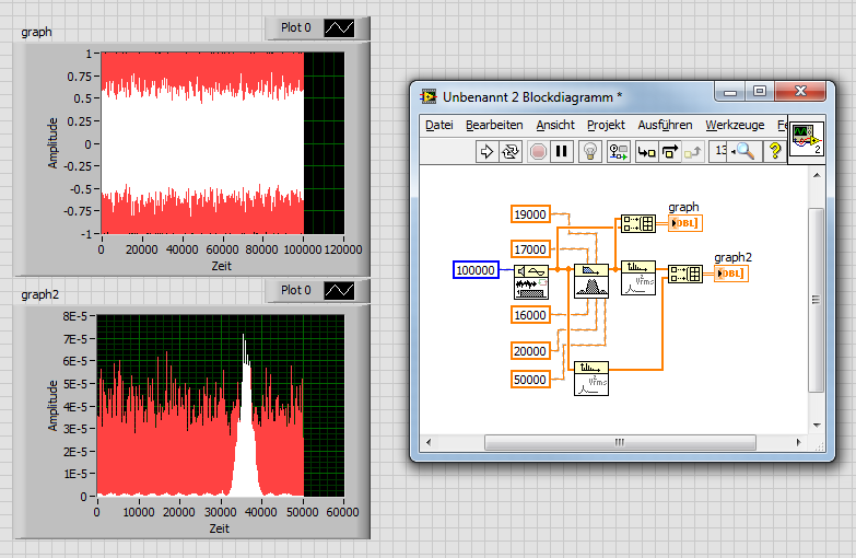

maybe your filter frequency settings are too "strict"? Using a wider band works fine:
Combining a passing band of 10Hz with a stopband of 30Hz needs a very high-order bandpass. Maybe you reached some limits in that bandpass function?
