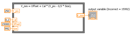

So, for saving few wiring I have programmed simple formula node:
Looks simple, isn't? But result was not expected, because this was interpreted as V_mm = Offset + Cal * ( 5 * Size);
The problem occur because the Formula Node accepts only the period (.) as a decimal separator.
No errors, warnings, etc!
Correct syntax should be:
Take a note, that on the BD constants looks like "0,2", not "0.2".
Well, technically both code above are OK.

Just for fun I checked this with CVI:
No warnings, and results absolutely the same as above:
V_mm 14950.800000
V_mm 15992.000000
And the Intel C compiler only said me, that
TEST.c - 2 warnings
 55, 1   (55): remark #174: expression has no effect
 55, 1   V_mm = Offset + Cal * (V_pix - 0,5 * Size);
Just would like to share this "very basic knowledge", because you may get the same trouble, which can't be easily recognized immediately...

Well, but again, for me "decimal comma" is fully OK. Used everywhere here. "EUR 1,49", not "EUR 1.49". Comma is just standard in Germany. On the Block diagram all constants - with comma separator, and I just typed comma in the formula node and got slightly incorrect result.
But sometimes such mistyping may cause big troubles...
What may happened if you will type "DO 5 K = 1. 3" instead of "DO 5 K = 1, 3"? — Mariner 1 crash
PaulG. wrote:
Let's convince our countries to make a trade. We'll adopt the metric system and you guys switch over from the comma to the period decimal separator.
Well, some of us measuring vodka in litres, another people measuring whisky in gallons... When both things are mixed, then the Gimli Glider incident may happened. Also Mars Climate Orbiter was crashed my metric/imperial mixup...
What I would like to say - just one warning message from LabVIEW (like Intel compiler does) may save lot of time. In my case that was no messages, and I was absolutely sure that the given code is correct. And result was nearby correct, but I was more than hour in hard debug session before figuring out what is wrong. Also be very careful and accurate.
