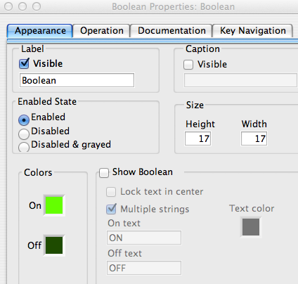

altenbach,
The default property for a boolean LED (which does not have boolean text visible) is with Lock text in center unchecked. It is checked on booleans which have text showing when dropped.
Well yes, but once it is set, e.g. after running the VI once, it never needs to be changed again unless the VI is not saved. (I was talking about the program default, not the system default. Sorry for not being completely clear).
