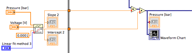

You should probably run your Fit VIs one time before the loop starts. There is no need to recalculate the slopes and intercepts (which do not change unless your  transducers change) on each iteration of the loop.

To run the Fit VIs one time just move them outside the loop and wire the slope and intercept outputs to the multiply and add functions inside the loop.  The vertical line is the left edge of the while loop.

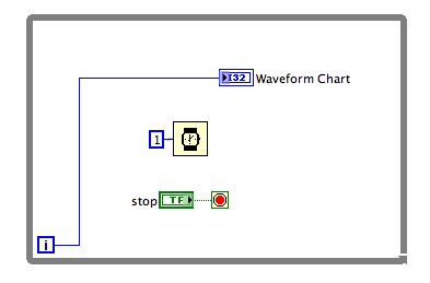

You can make the chart keep more data by changing the Chart history length. After you place the chart on the front panel, pop up on the chart and select Chart History Length... from the menu. Make the history as large or larger than the maximum number of points you want it to keep.  You may need to change the x_axis scale early in the process. If you set it to show all 172000 points, it will be hard to see any details.
Write a little test VI like this so you can try varius settings to learn how to get the chart to do what you want. This will run much faster than your pressure/temperature system.
