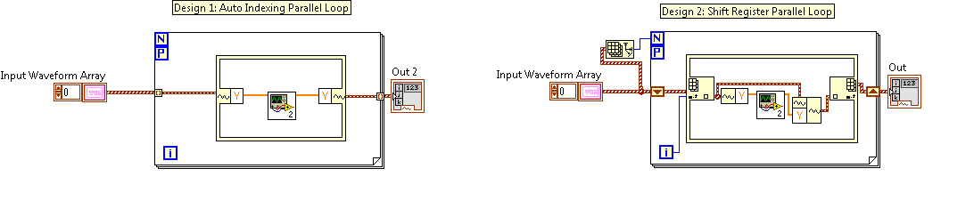

I have an array of waveforms in which each of them is quite large.
Making copy of them may push the RAM overloaded.
So I use in place element structure where in my case is allowed.
Because every wavefrom is independent, I can enable parallelism for optimize speed.
Which of the following indexing way best fit to my requirement?
Design 1: Auto-indexing
Design 2: Shift register
According to some articles, auto-indexing makes copy, while shift register ensures the same item is referred.
But shift register seems to be dependent from one loop to next loop.
How labview will do to them?
Or, no difference? Or, is there any better way?

The Array Index function in the second loop creates a copy

There are no array index functions in the code.
Something else occurred to me. There is also the question of what the VI in the middle does. Some analysis operations can't be done in place.

The shift register version won't run in parallel because the shift register creates a dependency between iterations.
Mike...
There is one in the In Place Element structure in the second loop with the shift register. Well, long name: Array Index / Replace Elements Border Node. It creates a buffer allocation.
It doesn't make a copy of the data.  That operation is happening in the memory location of that array index.  The Buffer Allocation is likely just a pointer.
This is incorrect.
The buffer allocation dot here is just in case the user tries to access an element which doesn't exist (like index -1).  In these cases the compiler must create something.
The vast majority of the time, there will by NO buffer allocation.  I know this because I use this in time-critical RT code.
