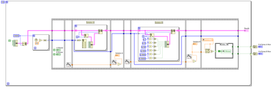

I'm currently working on a parser that has a ton of real time data it needs to parse.  There's a section in the data where the U8 is broken up into booleans.  For just a few data packets, the methodology wouldn't matter.  But with a ton of data, time is of the essence.  So I built this VI to test two methods of parsing to determine which method is faster.  I think (I THINK) I made the race fair.  I had to rebuild it a couple times.  Kept running into the randomness of LabVIEW which was making the race unfair.  Take a look.  Make a guess at which method you think will be faster then run it.
The challenge - see if you can make it faster.  I really am curious if there's a more efficient/faster way to do this.  The VI is in LabVIEW 2020 SP1. (I've added the VI and an image of it.)

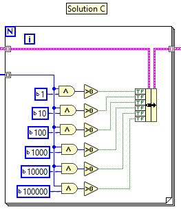

This is 33% faster than solution B:
I think the for loop is optimized to not make reallocations if the same array is indexed in and out of the loop…
I'm guessing everything will beat method A because of the extra step of indexing the Boolean array.  Ordinarily I might choose method A because of code clarity (you can easily see a miswired bit, not so easy to see that you ANDed the wrong value), but where speed is king, bitwise operations rule.
Now that's interesting. I thought for sure any amount of "rebuilding arrays" would cause noticeably slower parsing times.  That adjusting a pre-initialized array was faster.  Now I have to rethink how I'm doing the rest of my parser...
