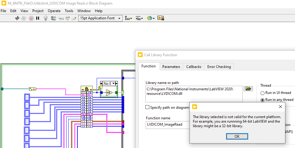

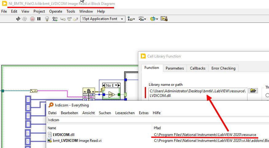

At the first - the path to LVDICOM.dll in bmt_LVDICOM Image Read.vi seems to be wrong:
The second problem is that when path was corrected manually, then LVDICOM.dll still can't be loaded, because of bitness - this is 32-bit DLL:

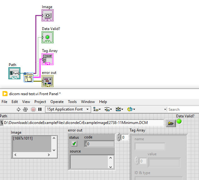

I replaced the LVDICOM.dll from the message above and it seems to be OK (at least I have seen correct dimensions of the DCM file, but don't ask me why Tag List is empty).
Not sure if this Library from older toolkit version is fully compatible with the latest one, but this is question for authors of the toolkit.
