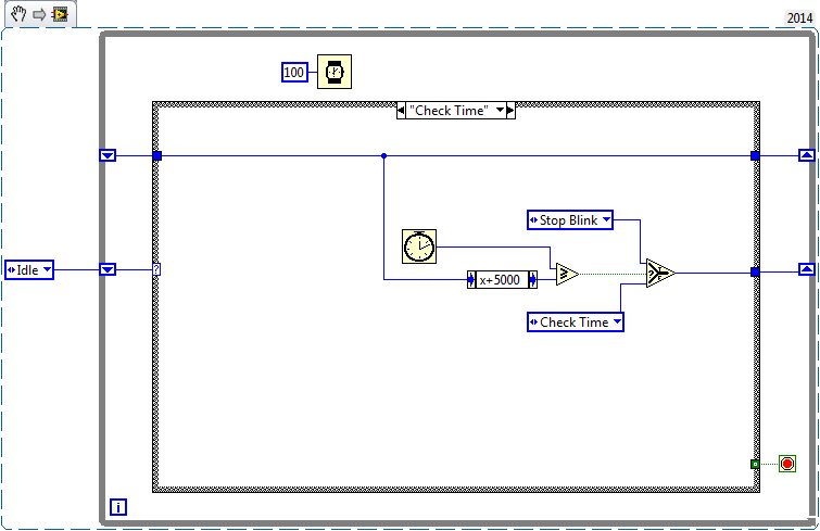

Here is an example for a single LED. You will have to expand it to work in different modes (I suggest extra states!) and for multiple LEDs. You will notice that I did not use a type-def, so when you add more states all of the other places that enum appears are "old". Consider that a free lesson!
Message 8 of 9
(5,154 Views)

today we got an example on how the task can be solved. Using a case structure with an enum to choose between the mods was absolutely the right way. In addition it would had been easier to directly use an array for the leds instead of single leds. I have attached a picture of one mod for you to see.
Once again, thank you very much for your help. I appreciate the free lesson 🙂
