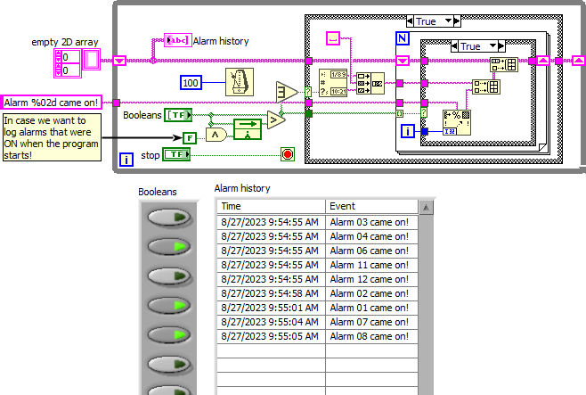

  • We are missing some subVIs.
  • Your 2D table data belongs in a shift register, no need for value property nodes.
  • You should NOT use an event structure. I assume you are polling digital inputs.
  • To only record FALSEtoTRUE transitions, you could do a NewVal > OldVal ("greater than"  instead of "not equal").
  • If you are using 19 array elements, you should either show all or add a scrollbar. It would be much more readable to use initialize array with a diagram constant defining the size. (Personally, I would just make the correct number of booleans the default for the array control)
  • What's the point of the error in/out? Isn't that a toplevel VI?
See if the attached very simple version can give you some ideas...
