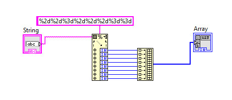

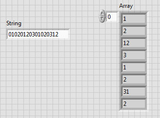

Thanks for your reply. This is as far as I've gotten:
code
When I run the VI, it separates the strings as desired. However, it omits the leading zeros. This isn't good because the database that I'm going to be querying needs the leading zeros. Also, I need the periods in the part number, but everytime I run it with the periods I get the error: The input string does not contain data in the expected format.

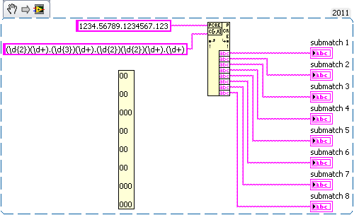

Try this. (I did not convert the strings to numbers but your SQL query will end up being a string anyway.)
Mark Yedinak
Certified LabVIEW Architect
LabVIEW Champion
