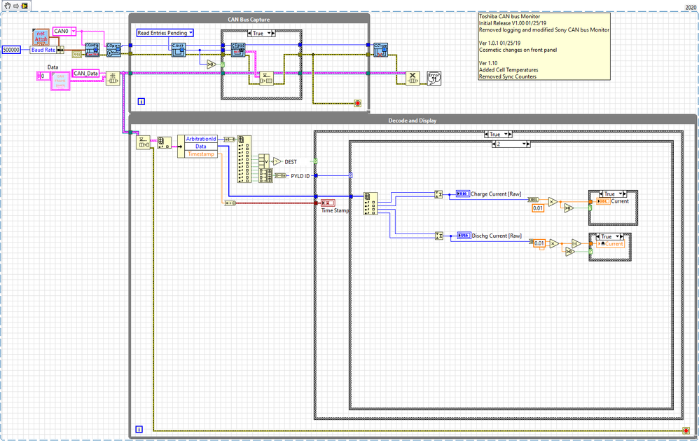

Here's an example of a CAN bus "sniffer" I write for a Toshiba Lithium Battery pack. It should give you an idea of how to do it...

So the payload contains 8 bytes and you want to create 2 numbers from it.
Are those numbers integers, FXP or SGL entities? (SGL because of your other thread where you also forgot to provide useful information.)
You may use UnflattenFromString:
(You may also use a typedefined cluster instead of the SGL array constant…)
