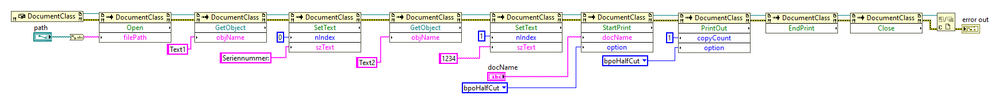

I created some sample code. This actually does print the label, but as I said once I send the print job to the printer, it do not get an event to tell me if successful or not. For example, if the print does not have a label cartridge, I can send the print job, but the job will fail.
James
(4,338 Views)

Can you please check out my snip of code and maybe give me some insight as to why I am getting the error?
(3,308 Views)
I tried changing up the code a little bit. And now I get no errors BUT STILL NO PRINTED STICKER. Is there other documentation on how to use .NET, rather than ActiveX with the printer? And where is the documentation in general? I have the P-Touch software on my computer and can print a sticker successfully. But as soon as I try, using their sample code or my LabVIEW code it doesn't work.
(3,304 Views)
You need SDK 3.4.014 (32-bit ver.) and LabView 32bit for the older models linke PT-9500PC and PT-9700PC. Otherwise nothing will happen.
And there is a doc bPAC34014us.zip
