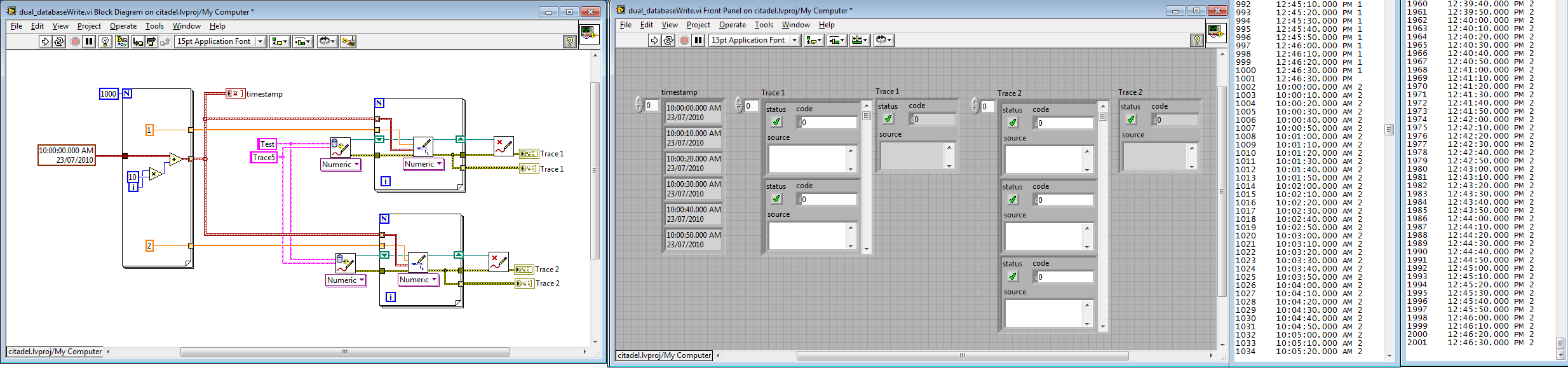

I have two distributed applications that can write to a Citadel database at the same time.
And I am investigating the possibility of what would occur if both of them were writing to the same variable at the same time, with possibly the same timestamp data.
I did this in the attached VI by using the same timestamps with a constant for the data (either #1 or #2).
This generates an error, as expected, stating you cannot have two references open at the same time.
The data file, dumped from Citadel, contains 1000pts with all data from only one of the arrays (in this case #2) and everything looks fine:
19711i26F4F40BD433437C
However, what appears to be happening randomly tho, is that the same portion of code can also returns no error.

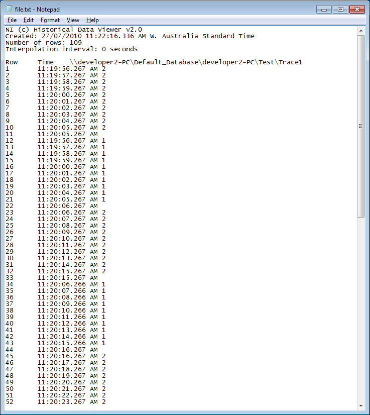

When the data is dumped from Citadel this file contains 2001pts - 1000pts from each array and one separator (or break) point:
19713i873266F7DC6A1EBB
You cannot write an older timestamp to Citadel without it throwing an error, but from further testing it seems you can write the same timestamp repeatably. So I am guessing what is happening above is race condition that is somehow allowing two references to be opened to Citadel which should throw an error but it does not and this is somehow allowing both sets of data to be written by both loops??
The data, IMO, is now corrupted.

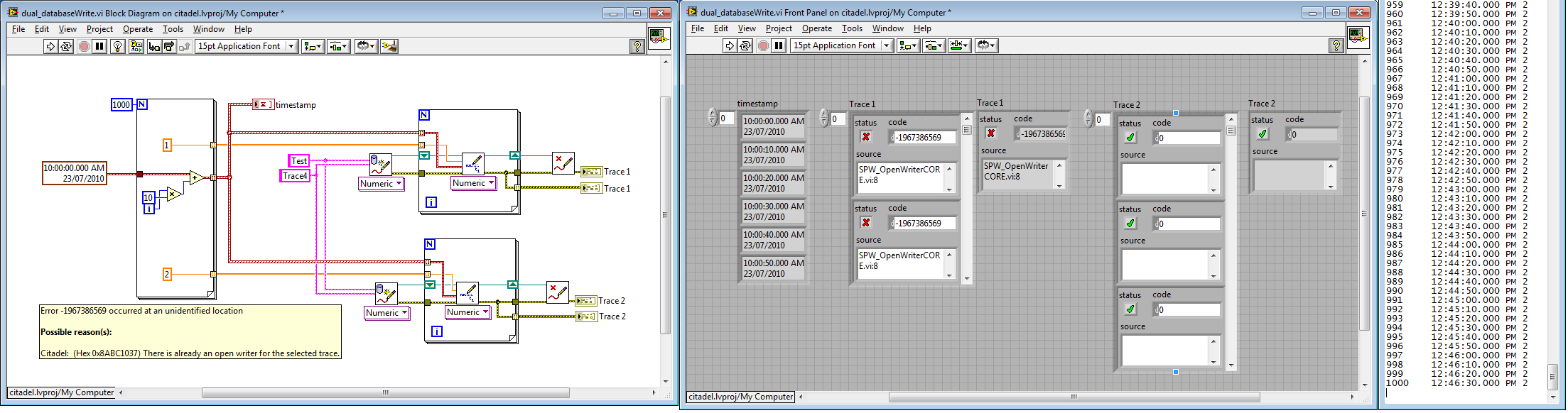

I have applied for a service request (Reference#74887) with NI here (Australia) for this thread.
I was able to corrupt the database using your code just running by itself:
19933iDEE1610A5C8DCCBC
I still think there is an issue/bug with allowing two open references in the same VI.
However, I am wondering if the Test Case presented is valid.
I will not be opening two references to write in parallel in the same VI rather, there is the possibility that two writes may occur from two different VIs and that is what I was investigating
E.g. Running two VIs writing at the same time always seems to create an error which is good news, I haven't managed to corrupt the DB that way.

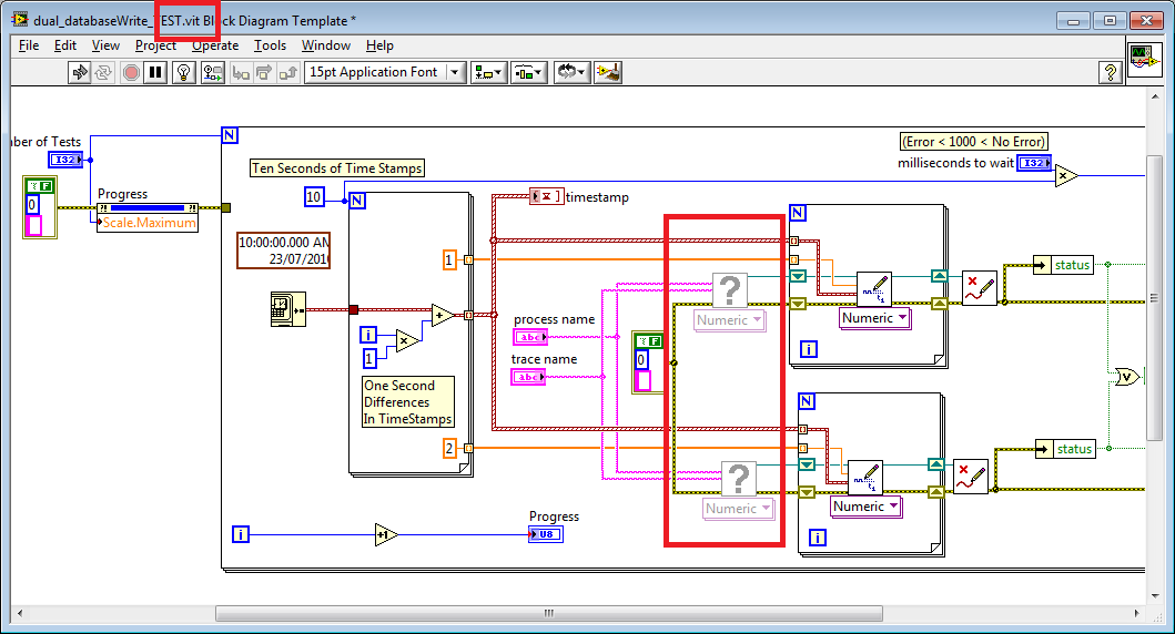

Additionally I may have come across another issue:
I changed your VI from a .vi to a .vit and it became broken:
The Open Trace.vi (polymorphic) now becomes "missing"
All I have to do is drag and drop it and it relinks, and after that it seems to be fine
But I have had builds break in the past with this VI.
The workaround is to use the actual referenced VI on the BD, not the polymorphic VI.
So I think something maybe weird with the polymorphic VI.
Can you replicate this?:
19935i0A9C3C0DC42906C3

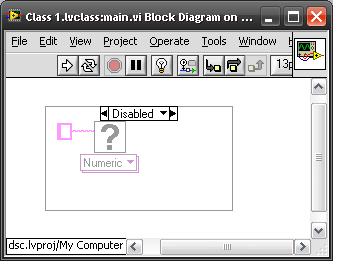

Next place a disabled structure around the Polymorphic VI (as Class Member or not, it doesn't matter)
Save the VI
Close the VI
Open the VI - the Open Trace.vi polymorphic is "missing"
20373i47D3942E2A16AD1B

I was able to resolve the first issue by following step 2 in the document, Error 1003 Occurs When Trying to Create an Executable. It appears there is an issue with that Polymorphic VI that causes it to need to be relinked. I bet this is the same issue that causes it to go missing with the diagram disable structure. For the missing VI issue, I created CAR (Corrective Action Request) 243120.
In regards to the .vit issue, that is to be expected. A .vit file contains additional information that is added by LabVIEW when you save it from the Programming Environment. By chaning a .vi to a .vit in windows, you are meerly changing it's extension which can change what kind of a file a program recognizes it to be. For example, if you create a .txt file and rename it to be a .docx file, word will recognize it as a word file extension, but will not be able to open it as it is not actually formatted in the word format.
