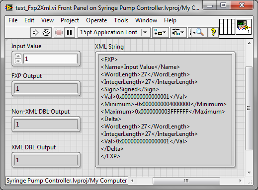

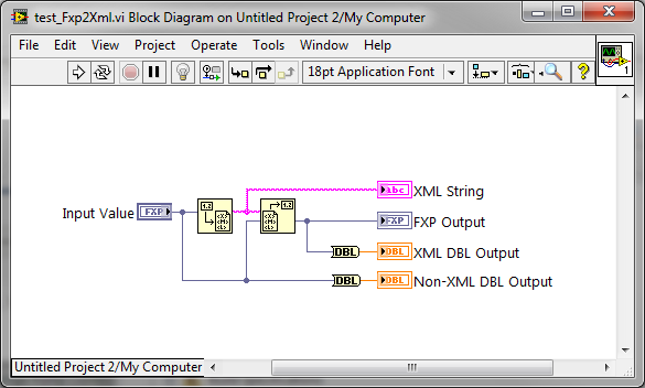

I've found a bug in the Flatten To XML VI, when handling fixed point values on a CompactRIO. It's really insidious because the unflattened value still looks correct, but everything falls apart when one tries to convert it to a different representation. I've reported this to NI, but thought I'd share it here so that others are aware of it.  Here's a minimal test case:
This is the correct result, when the VI is run on my PC:

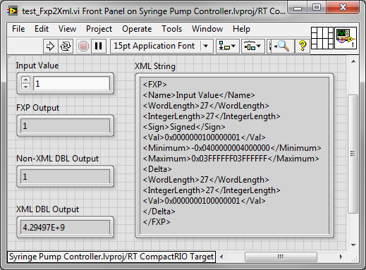

This is the wrong result, when run on my NI-cRIO 9076:
