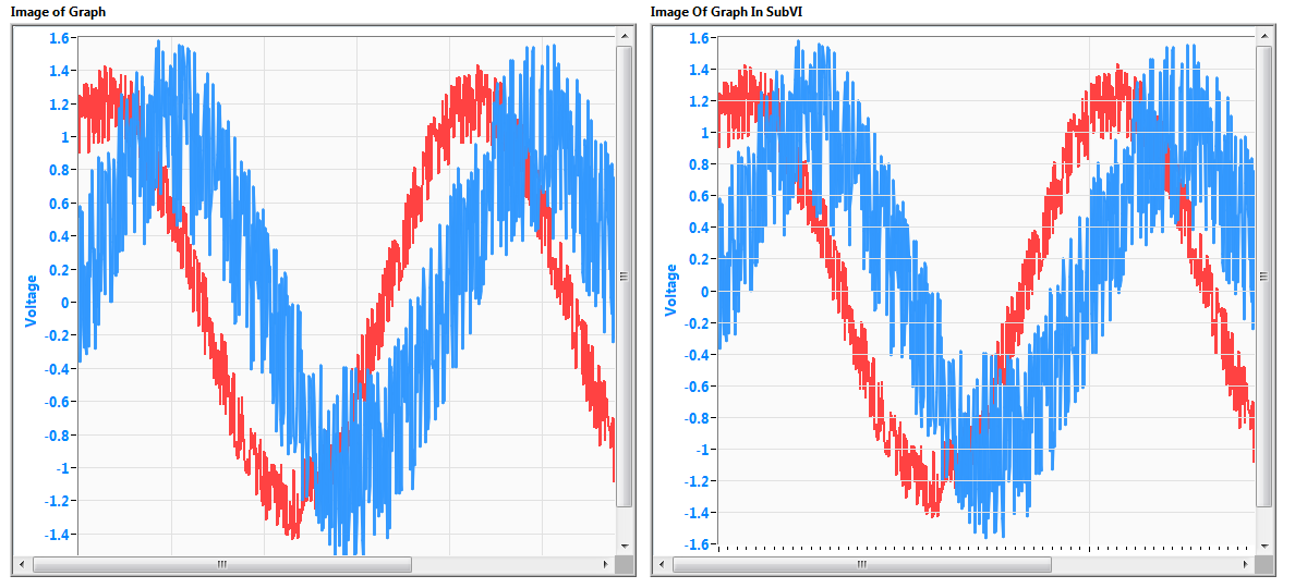

I'm using the Get Image method on a control reference to generate a graph that goes into a PDF report.  I noticed for some reason the grid lines on my graph were on top of my plots which I thought was odd but I didn't really care because you could still follow the trend.  Unfortunatly our equipment is getting quite precise on the measurements and the scale zooms out enough that our plot line might only be a couple of pixels in size, and the grid line has a chance to cover up the data.  After looking into it a bit the reason for this seems to be that the Get Image method behaves differently if it is taken from a graph that is in a front panel that is open, or if it is closed.  Here is an example:
In this simulated data it isn't as big of a deal, but as I said if my actual data was -1.4 the whole time, it might be hidden by the grid line.  Attached is an example which behaves the same way in 2015 SP1 32-bit and 2016 32-bit on Windows 7 x64.

Edit:  Okay so it seems replacing the graph with a silver graph, makes the issue go away.  I just then need to change the silver graph to look like the system one.

If I capture the image twice I end up with the same image twice, and overlaying them would appear the same as capturing it once.  My example shows that getting the image one way is incorrect, and the only way to make it work properly is to show the front panel of the VI with the graph and that is not something I want to do.

Second your HTML graph missed the point.  I was showing that the control reference of the graph in the subVI is the one that doesn't display it correctly.  If I wire the other control reference the same issue is seen where the grid lines are on top of the data, in the HTML file created.
The last thing is you mentioned that if the VI's front panel isn't open then the values aren't updated...but clearly they are you see the graph and you see it has data that isn't saved as default of the control.  So while you say the values on the front panel won't be updated, they clearly are, and do reflect the values from the last time that VI was ran even when the front panel isn't opened.  Is this an unintended feature?  If so I'd like to submit it as a request to be an actual feature that is supported, instead of one that is is implemented but 1% of the time acts weird.

The elves changed the update mode of the Graph in the SubVI, and with the Strip Chart Update Mode (default) it behaves in that way, but with the Scope or Sweep Chart Update Mode (Front Panel of SubVI-Right Click on Waveform/Advanced/Update Mode/) it shows the data with the grid behind.
So, it may be expected for the way the Strip Chart Update Mode works.
