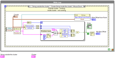

Hello everyone, I've encountered an issue with the 'Byte Offset from Point' method in LabVIEW. It seems to work fine when applied to a string directly, but when the string is within a cluster, the method doesn't function properly. Has anyone else experienced this issue, and if so, do you have any suggestions for resolving it? Thank you!
I have attached a simple code for demonstration.

My code as png:

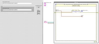

Hi Max,
I see the same behaviour in LV2019:
The byte offset is shown correctly for a string control on the front panel, but not when I move the string control into a cluster.
With string inside cluster I always get a result of "19" (aka string length)…

that my code but I don't know what I'm missing... I think it's the initial position given to Get Text Rect.vi.

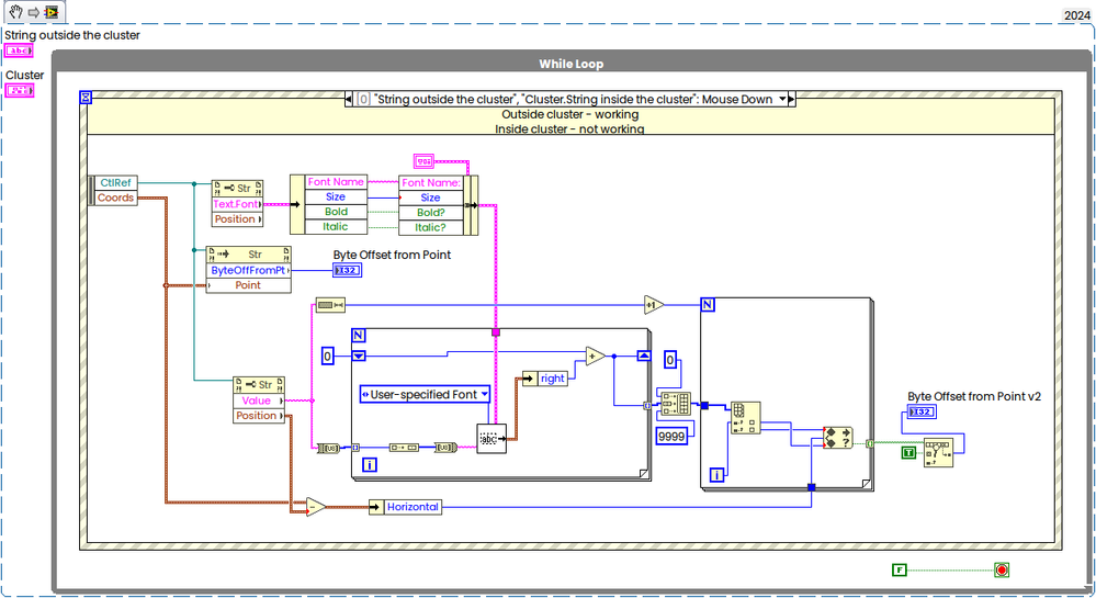

@maxnoder1995 wrote:
I have a Mouse Down Event configured on a string control that resides within a cluster. When the mouse is clicked within the string control, I need to determine the byte offset of the clicked position within the string.
I have to do it without  'Byte Offset from Point' method.
This small snippet should give an idea how to achieve this. Its not ideal, needs to be "fine tuned" for the clicks exactly between the chars (currently may give wrong answer), but I hope overall idea should be clear more or less.

Wow!! Thank you very much.
Use "Text.Positon" instead of "Position" to be precise.
If my text is justifed to the right, do you think it will be a problem to make it work?
