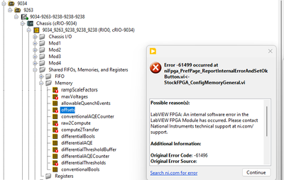

I have LabVIEW 2025 Q1 and in a project with multiple CRIOs, many of the memory items in my project for multiple targets have been deleted or are corrupted:
I have always been plagued with issues regarding the memory items, however, it seems that a recent update or change has really broken things.
Any ideas what happened or how to fix?
Many thanks

Seemingly related to this issue....https://knowledge.ni.com/KnowledgeArticleDetails?id=kA03q000000xBFtCAM&l=en-US
Any suggestions on how to overcome? Or even just to restore my memory items?

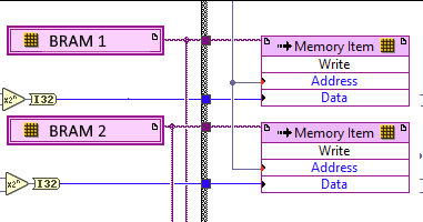

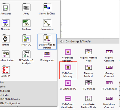

I never create BRAM in the project. I always use the tools to instantiate directly on the block diagram. The following is from a Flex-RIO target, but I would assume the same is available for your target..
You should have the ability to drop a "create BRAM" on the block diagram where you can open the configuration dialog to set up everything you need.
The best advantage is portability, the source code is self-contained. If you need a second copy, just copy the VI on the BD and you're already ready to go. In VHDL, the BRAMs get named based on their full hierarchical path, so they will still be uniquely named internally.
As you can see above, the same ability should exist for Registers, handshakes, FIFOs and Block RAM. The only thing I would like which is NOT supported is DMA FIFOs (To or from target). They must be project items.
