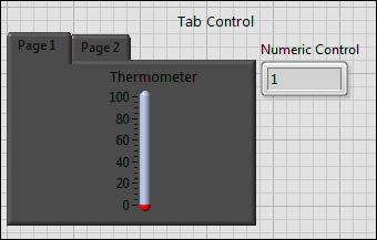

Create a tab with objects.
Click an inactive tab with the paintbrush tool :
The tab label changes, but the objects inside do not:

Because it's white the bevel looks like its disappeared.  Are you sure Tab 1 is active, or does it just look like it?  I don't have LabVIEW right now to check.

The color doesn't matter, it's switching tabs without changing the container contents.  The color updates but you still see the controls/indicators from the other tab.

Page 2 is the active page!  The tab graphics seem to have a cosmetic issue.  Nice catch

Thanks for reporting this issue. I was able to reproduce this behavior. I will file a corrective action request on this subject.
