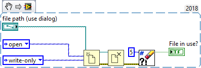

I'm going to guess at your intention here because I'm not sure-
It seems like you have a .exe file on your network somewhere, and you've made an update to the source and want to rebuild the executable. The problem is that if someone is using the executable, the build process will throw an error.
If that's right, use the following:
(Note that if you don't have permission to write to the network drive, this function won't work.)

Your network administrator may be able to check, but otherwise altenbach's solution (or similar) is the only way to know.
