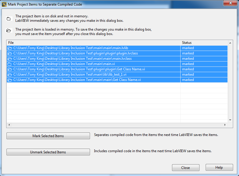

Your plugin source is all marked with separated compiled code. Your exe only hosts the run-time engine and will not be able to load the class or VIs since there is no object code present (all in the IDEs cache). You can confirm that this is also the case with your source distribution - when your main.exe is running, try using "Open" in the menu to actually open the Get Class Name method of your distribution from disk. LabVIEW tells you that the plug-in source has no compiled code. Correcting this allows the plug-in to appear to load without error.

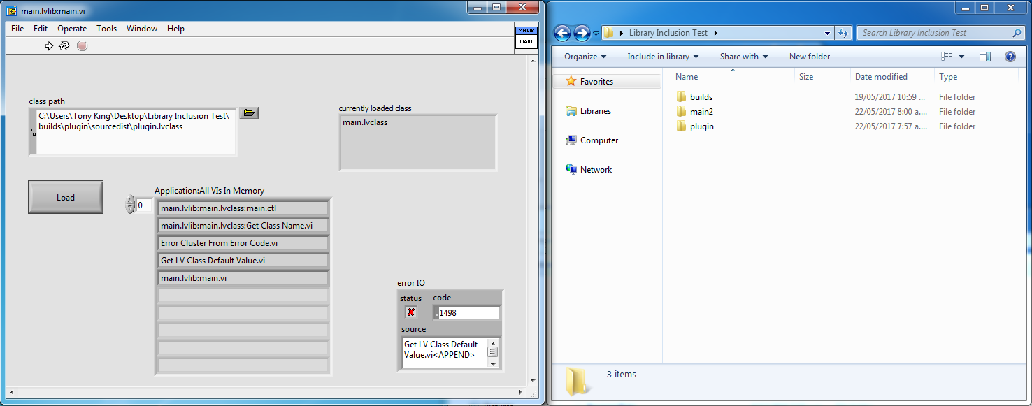

  • When you load your plugin in your main.exe it actually loads the original source copy in from disk. You can tell this from these screenshot where, prior to loading the plug-in for the first time, I deliberately renamed the "main" folder on disk to "main2" so that the absolute path would no longer be the same. As you can see it can no longer load the plugin:
Whether this is a problem for you depends on the scope of your project and whether you want the plug-in to be able to access any run-time information from VIs, variables etc. from the run-time main.exe:main.lvlib.

Thanks a lot for pointing this out tyk007! We already discussed this as a possibility, but excluded it because we thought that the compiled code would always be there for executables. Unfortunately, there is also no option to explicitly set to include the compiled code as there is for source distributions. Also, we were really hoping that separating the compiled code from the source would not be the issue, since we're using SVN for version control and it is really annoying that VIs "change" just by opening them.
