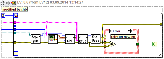

How a fix to this problem could look is explained above: add a for loop in vi.lib/Platform/icon.llb/Write Icons to Application.vi:
Please NI, give it a try.
Workaround until then: Every user running into this problem can modify the VI himself.
And NI, do not forget to to fix the error handling in EndUpdateResourceA.vi. (Wrong merge order, marked in image with red arrow. Details are somewhere above in the thread.)

@shb wrote:
I have modified EndUpdateResourceA.vi to call getLastError when the dll call returns zero. (This is recommended in the help of microsoft for EndUpdateResouce. This is the function called by the dll call.) The returned error code is 110, which means that the system can not open the file. (The file is referenced by hUpdate.) (Message found by calling FormatMessageA in kernel32.dll.) This is similar to LabVIEW Error code 8.
My recommendated changes to EndUpdateResource.vi:
  • Swap the error inputs of merge error. Like it is now an error which occurred before could be hidden.
  • For getting the windows error call getLastError when the dll call returns 0. (In case windows error is 0 raise an error as fallback.)
  • When the windows error number is unknown, call FormatMessageA for getting the error message for showing to the user (VI appended)
  • When the windows error number is 110 then
    • the error could be replaced with LabVIEW error 8 (not done in snippet)
    • maybe trying to write the resource could be repeated several times (not clear from MSDN documentation)
      • when repeating works, the resource should probably be discarded in an error event (fDiscard=1, not done in the snippet)
      • when repeating does not work here, repeating could be done in the calling VI (Write Icons to Application.vi)
The BD of the VI would look similar to this:
Greetings,
shb
