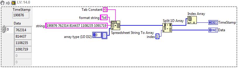

That is what I did in my old code. (See attached)
This process works great, but I cannot see the data on the plot until after I have stopped the VI.
Can I use the "Spreadsheet String to Array Function" inside my main loop?
My problem with this is I would need to split the string at my new line characters so I do not get truncated data.
Yes.
Sorry thats not a problem, it is either because you are too lazy to program that in or you are very new to LabVIEW. If it is the latter, please look at some LabVIEW tutorials.
The VI in your first post is waiting for complete data and the conversion happens in the case structure. Please do the same here.

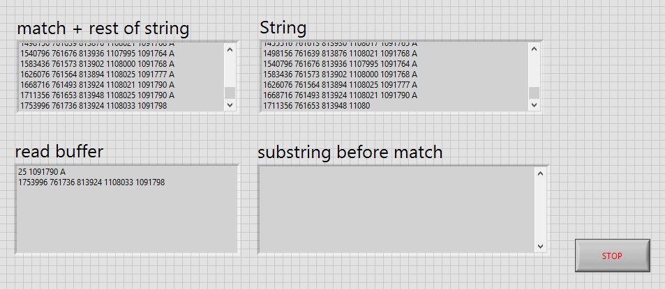

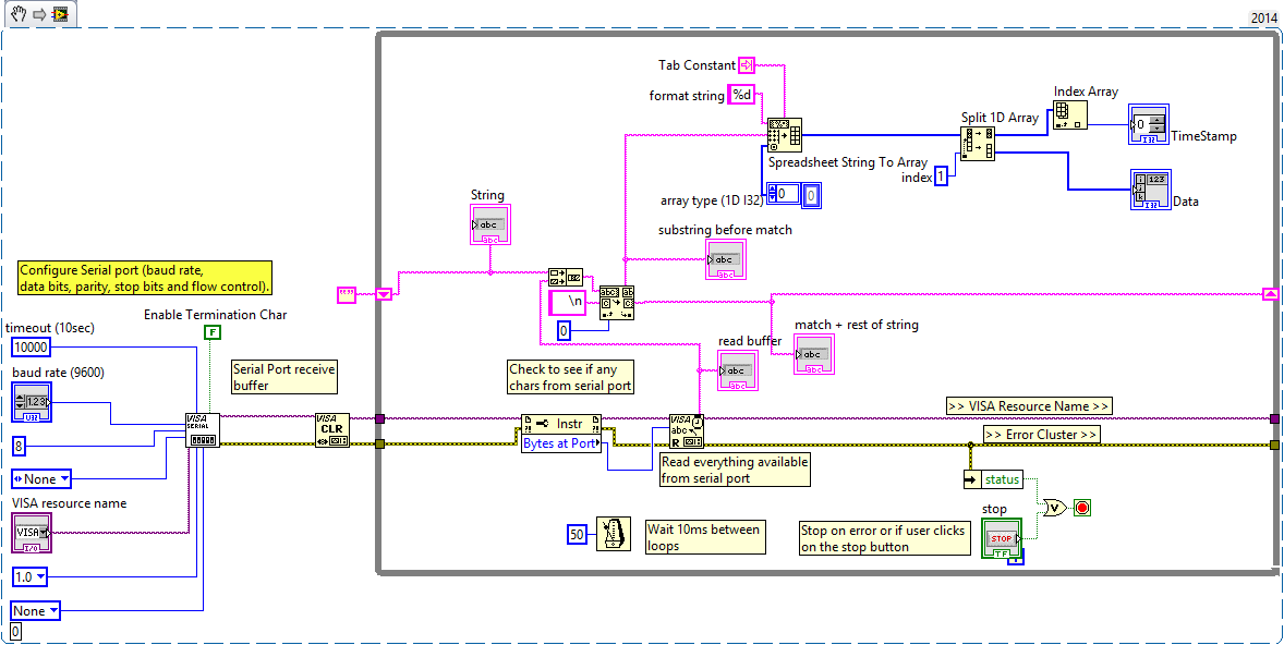

OK,
I think I am back to where I was on the first post.  I need to pull the data into my loop, and split the string.  What the first code was doing with the regular expression. Here I am trying to do it with a "Search/Split String Function" that searches for a new line indicator, and split the sting at that point.
My thought processes is that I can than read all the data before the new line indicator, and let everything after the new line indicator loop to the shift registers. This however does not seem to work.  In the code I have provided, the "Search/Split String Function" lets everything pass.  i.e. it splits the string at the last data received, and not at the new line indicator as expressed in the code.
I also tied a \r and \r\n, but I get the same results.
I need to find a way to split my strings at the newline indiactor, or as stated before " waiting for complete data".  How can I build a VI that knows when the data is complete (i.e. It sees a new line), and then pass that stiring on.
Here you can see my CI is taking anything in the buffer and letting it pass through the "search/split function"

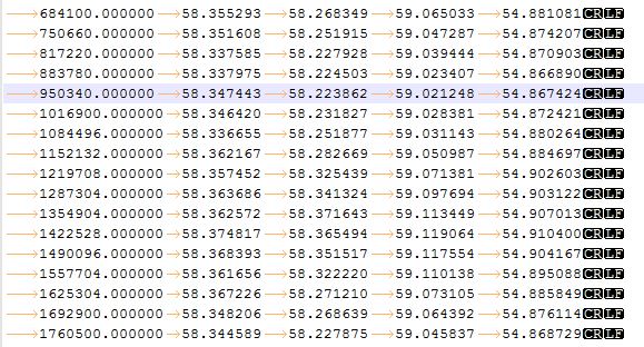

For completness, here is what the data coming in looks like in notepad++
Thanks in advance.

Just a small observation.
If there is no match then "match + rest of string" is an empty string. In this case you should pass the "read buffer" string to the shift register. If you have a match then you shouldn't pass the "match" part to the shift register, just the "rest of string" part. The first time you have a match the character \n will always return as the first character in the next loop iteration so "substring before match" will always be empty.
Ben64
edit: How does the data in Notepad++ relate to the read buffer data?

Don't use bytes at port!
Take advantage of the termination character you have.  Enable it on the Serial Configure and set it to the linefeed character.
Now the VISA Read will wait until it has the entire line (or timeout if it doesn't come).  Then you can parse your data from there.
I think the problem with your code is that you are searching for a backslash n.   Not a line feed character.  Turn on the the display style for that constant and you'll see it is set for normal display and not backslash display.

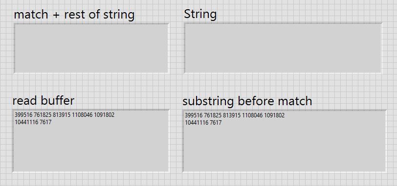

Ben64,
The data in notepad++ is how the data come in over my VISA.  I posted it so everyone would know how the data is coming into the VI.  This is what I am trying to split line by line so I can extract each data point.
I tried what you said, see the resulting outputs.
The same problem seems to reamin.  It does not seem to split the line at \r or \n.
Maybe I need to search for a real string in my code.
I still don't understand why I can't just search for a regular expression that matches my line....
Thanks for your comments, any other ideas would be welcome.
