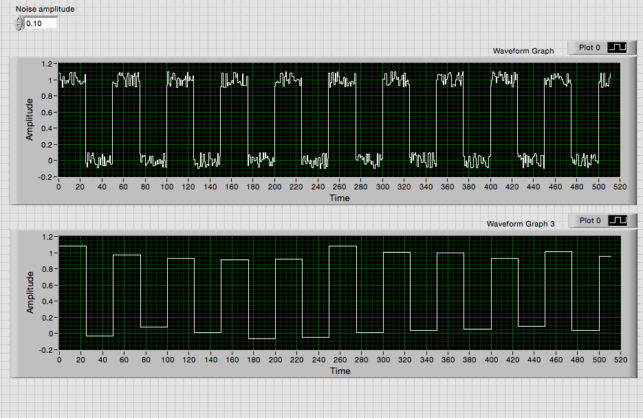

Which type of signal do you want?

Or for digital signal recovery, do you want to randomly add our drop a bit?

I want first one, I need that kind of noise to my pulse of 1s and 0s signal,
Thank you
