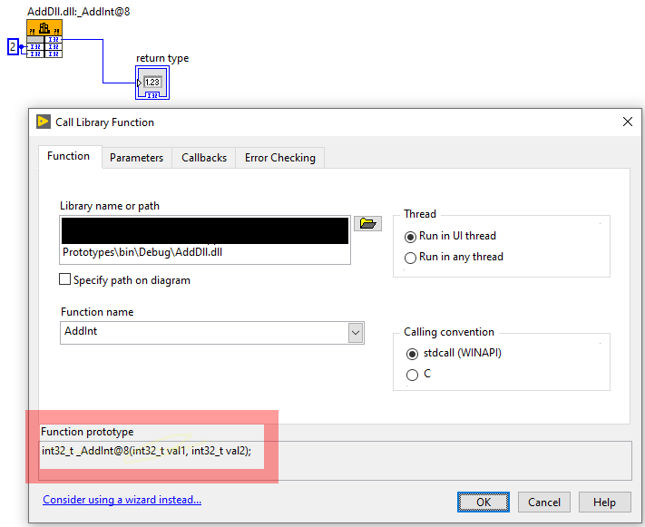

Inside LabVIEW 32 Bit, the parameter size is appended behind the function name:

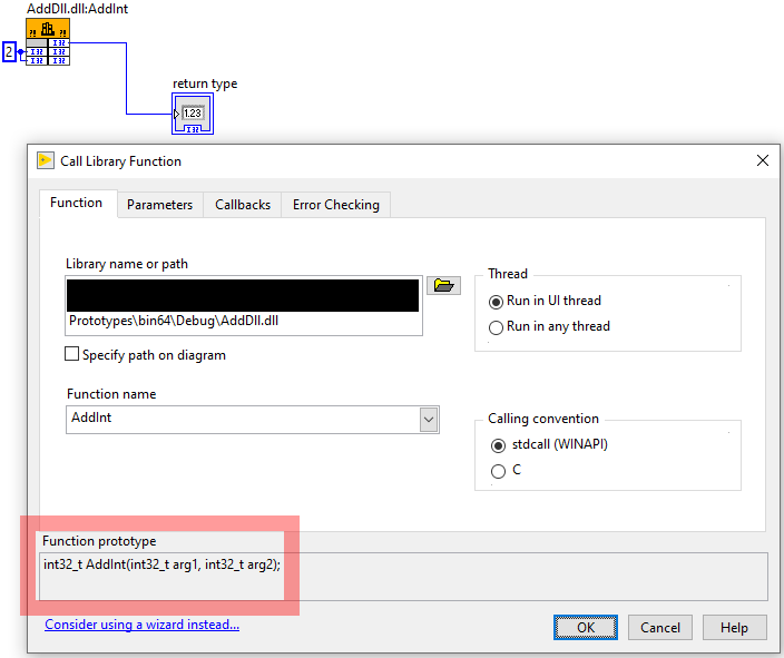

However, inside LabVIEW 64 Bit, the parameter size is not appended behind the function name:

The appended parameter size is a feature of the __stdcall calling convention. It is something Microsoft compilers actually always make for such functions and NI follows that lead (I'm not even sure if it would be valid to force the linker to suppress that decoration).
The LabVIEW Call Library Node should be able to deal with that. When you enter the name without that decoration, it still will call the according function.
But there is also another solution. Configure the function to use the __cdecl calling convention. In this case functions are not really decorated (well sometimes they can be with a prepended underscore, don't you like those pesky C compiler developers?) but anyways LabVIEW is actually actively trying to link to a name with an underscore even if you only enter the undecorated name, if it can't find the name as you have entered it.
And the Windows 64-bit platform neither uses the __stdcall nor __cdecl calling convention, but instead always (well for user space software at least) __fastcall, just to make it more funny. LabVIEW on 64-bit doesn't let you choose a calling convention at all as it always will use __fastcall.

Well this explains it all. With __cdecl I get what I expect.
I used __stdcall because the LabVIEW application runs only on Windows and windows does use __stdcall convention for all Win32 services.
